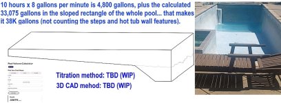

While this thread is all about using free CAD software to model your own pool, the simple arithmetic volume math gets a lot easier once the entire multi-sloped bottom of the pool is filled with water (which eliminates some of the uncertainty in the oddly shaped calculations).
You end up mostly with two main calculations:
  1. Measure the volume needed to cover the sloped sections
  2. Calculate the volume of the simpler-shaped top section
Using only one garden hose (so as to not overstress the well pump and water pressure booster pump) for 30 hours x 8 gallons per minute (over 6 days elapsed time) ends up being about 2,500 gallons per day for a total of about 14K gallons in the variously sloped sections.
Now that the water covers all the variously sloped sections, the remaining rectangular box above the pool is more easily calculated at 60 feet long by 15 feet wide by about 36 inches left to fill, for about 20K gallons. This latest (simplest) two-part estimate of pool volume comes up with the lowest amount yet, of about 35K gallons (give or take).
There's a bit of slop in where to count the fill line, where every inch that is off is a bit over 500 gallons of water so we have to be careful of sig figs.
