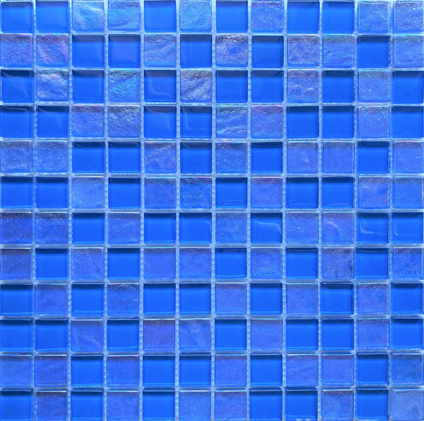

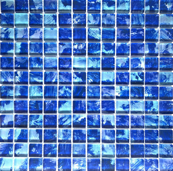

LOVE the view! Here are some 1x1 tiles I found that I think would work great!
I like the lighter colors and think this would blend in with your view great:
This one is oh so pretty! Not really to sold on it for the view though:
Anyone that knows me will know why I love this one-THE BLING!!! I think this one would also blend in with your view:
I also love the 1x2 tiles in the same colors.

Thank you! We like the first and third ones the best. I'm also torn between matching the finish color vs. going slightly lighter or darker. The bevel on the vanishing edge faces the front of the pool, so we want it to blend in with the pool finish and the view. We don't like EcoFinish all the way up the edge, just EcoFinish below the water line if that makes sense.
Upthread mknauss mentioned issues with glass tile in SoCal? Should we look into a different type of material? I'll ask our builder as well.
Calcium scale build up will make maintenance of glass tiles (especially if you have lots of grout lines) challenging. It will help if you use softened water for make up water due to evaporation.
Thank you for the reply. Is there less calcium buildup if we use ceramic tiles on the lip of the vanishing edge or it's mainly the grout lines? Would you recommend another material instead? Would you just EcoFinish all the way up to the vanishing edge on that part of the pool?
Scale will build up on ceramic tiles also. Anywhere there is a water line that you have evaporation. Easier to clean off ceramic tiles.
No idea on vanishing edge or Eco Finish. Scale will build on it also if there is a water line. Vanishing edge pools are complex to operate.
Got it, thank you. We can look into ceramic tiles. The water line is at the level of the vanishing edge. That lip portion of the pool is what we were looking for options of 1" x 1" glass tiles. The non-vanishing edges of the pool will be ceramic tile that looks like limestone and wraps over the edge with miter edge where the tile meets. That portion will have a water line on the ceramic tile. I think because of its lighter limestone color, hopefully calcium buildup will not show as well. Thanks again.
