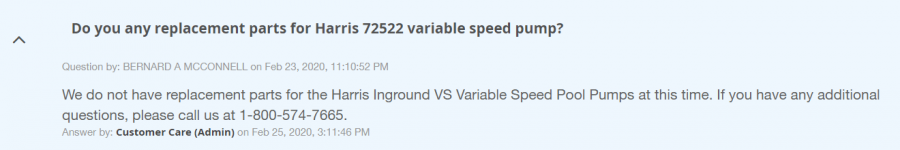

Yikes. My search and Doheny's site don't bode well for "go kits" (which are a collection of all the seals for the pump)...
Nope, I wish they would have some kind of kit for repair but they don't. Just didn't know if someone else had run into this and had some numbers or info. It's leaking worse now than last year, so I guess at this point all I can do is pull the motor off and see what's in there.

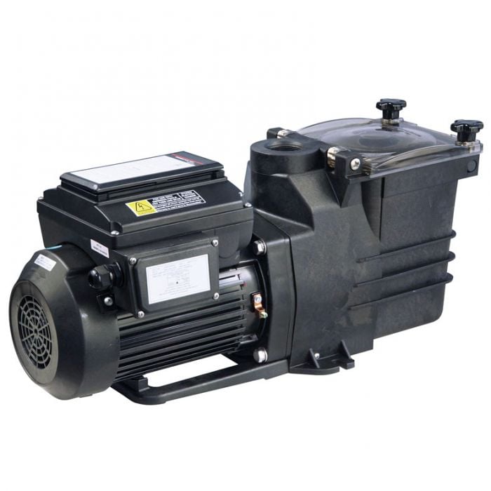

Pump looks very much like a combination of a Hayward Super Pump and Max Flo. If so, the seal between the two part is actually called a gasket and it looks like a rubber band that fits into a slot on the front portion of the pump. Wouldn't hurt to remove the 4 bolts and look. If so, Doheny's has a GO kit,:

Did more research because it was interesting. Look at the picture of the Hayward Super Pump below and compare it with the Harris, very slight differences. It would take GO Kit-3 for a Super Pump. Both Hayward and Waterway have been making their wet-ends available to other companies without their name on them for years. Advantage Electric, a motor repair business, sold pumps with the same wet-end as the Harris many years ago.
