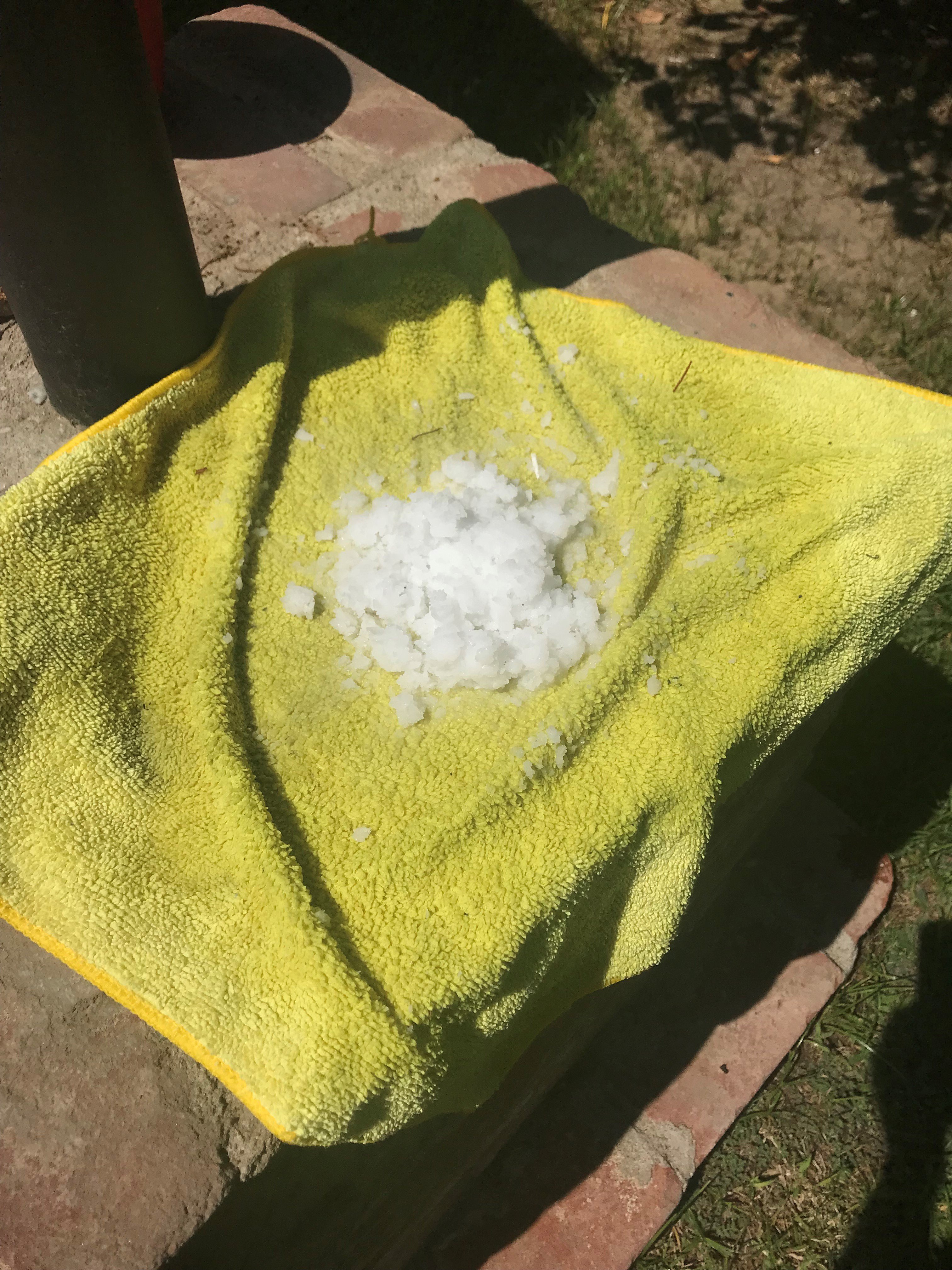

After a recent cell cleaning, yesterday, my RJ-60+ shut down again today (low salt, cell maint light) after maybe 6 1/2 hours of actual run time (10 hours at 65%).
This is not the first time this has happened. I watched the voltage rise slightly and amperage numbers drop off a cliff in 4 hours this morning. The calculated salinity went from 4700 to 2400ppm in that time.
I shut down the pump and pulled out the cell today and was amazed by the amount of scale in the cell in the short amount of time.
I will weigh the solids after it dries and try the fizz test for Ca. I may also test for Mg. I have never added salt to my pool other than what was there due to liquid chlorine and MA over 4 years. In fact I had to drain and
refill enough to drop the salinity from 4500 to 3500ppm before starting the cell a year ago in the spring.
My current water test results:
pH 7.2
TA 40
CH 250
Salinity 3800
Water temp 86f (temp from cell sensor 92f)
CYA 60 with FC at 7.5
Now I admit to not using the CircuPool recommended cleaning method. (fill cell with 1:4 MA solution until reaction stops)
Yesterday besides using the zip tie I also used acetic acid 4% in a spray bottle followed by a high pressure hose.
CircuPool does answer their emails and they remarked on the issue of water balance and best LI numbers. They also said that it may take 2 or 3 cleanings for best results.
Today after the zip tie I used a 1:10 MA solution as a spray with hose chaser. The hot acid bath is my next option if this continues.
Any ideas how to mitigate this? I can live with a 30 day maintenance schedule but this after only 24 hours is an issue.
Any thoughts on additional water quality testing to diagnose the issue?
Should I explore my TDS numbers?
Maybe market this as a calcium reducer for residential pools? :scratch:
Any thoughts?
Thanks. :cheers:

For such low CH water that seems like way too much buildup. I have never checked the swg but I'm wondering if there is an issue with your unit (ie: cell reversing aka cleaning mode).
It does not look like normal calcium carbonate.
The main types of calcium scale are calcium carbonate, calcium phosphate, calcium silicate and calcium sulfate.
It might be calcium phosphate.
Check the phosphate levels.
Test the scale with acid to see if it fizzes.

No scale inhibitors and I may have a water quality test done last year from an ag lab that details the Phosphate level and TDS then. I may want to run a current test. I did the fizz test and there was a rapid reaction and the sample was completely dissolved after a bit of agitation.
I collected the scale from the bottom of a 5gal bucket after using a hose nozzel on the soft buildup in the cell and spraying maybe 8oz of 1:10 MA into the cell and into the bucket. I decanted most of the 4+ gallons of solution then strained the bottom dregs with the yellow towel. That may account for the unusual "look" of the scale. Thanks JamesW for the suggestions on possible diagnosis directions. I will review your links.
Calcium silicate is an interesting idea as well as I did just clean and recharge my DE filter with silicon dioxide, DE prior to this rapid cell fouling.
