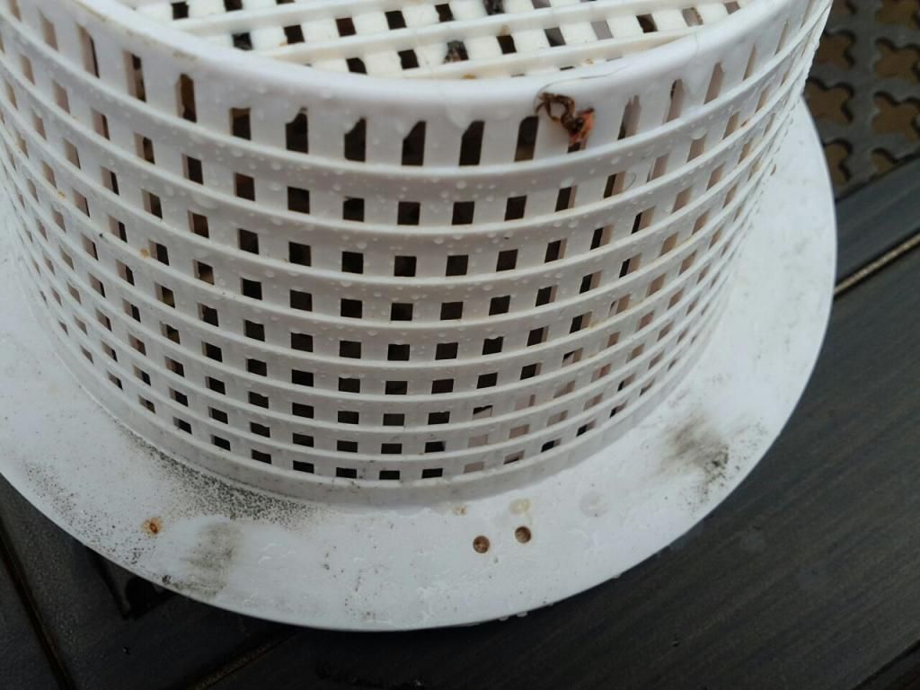

Look what I just found, I promise it wasn't there yesterday.
You can see how it is greasy where I smeared it with my finger, but you can also see the individual "dots". I have never seens the dots before. Could that be some sort of colony? Bacteria? As you can see, when smeared, it is not green.
I scrubbed it with a 50:50 solution of bleach and water. I also cleaned the scum line from the skimmer throat with the same bleach solution.
