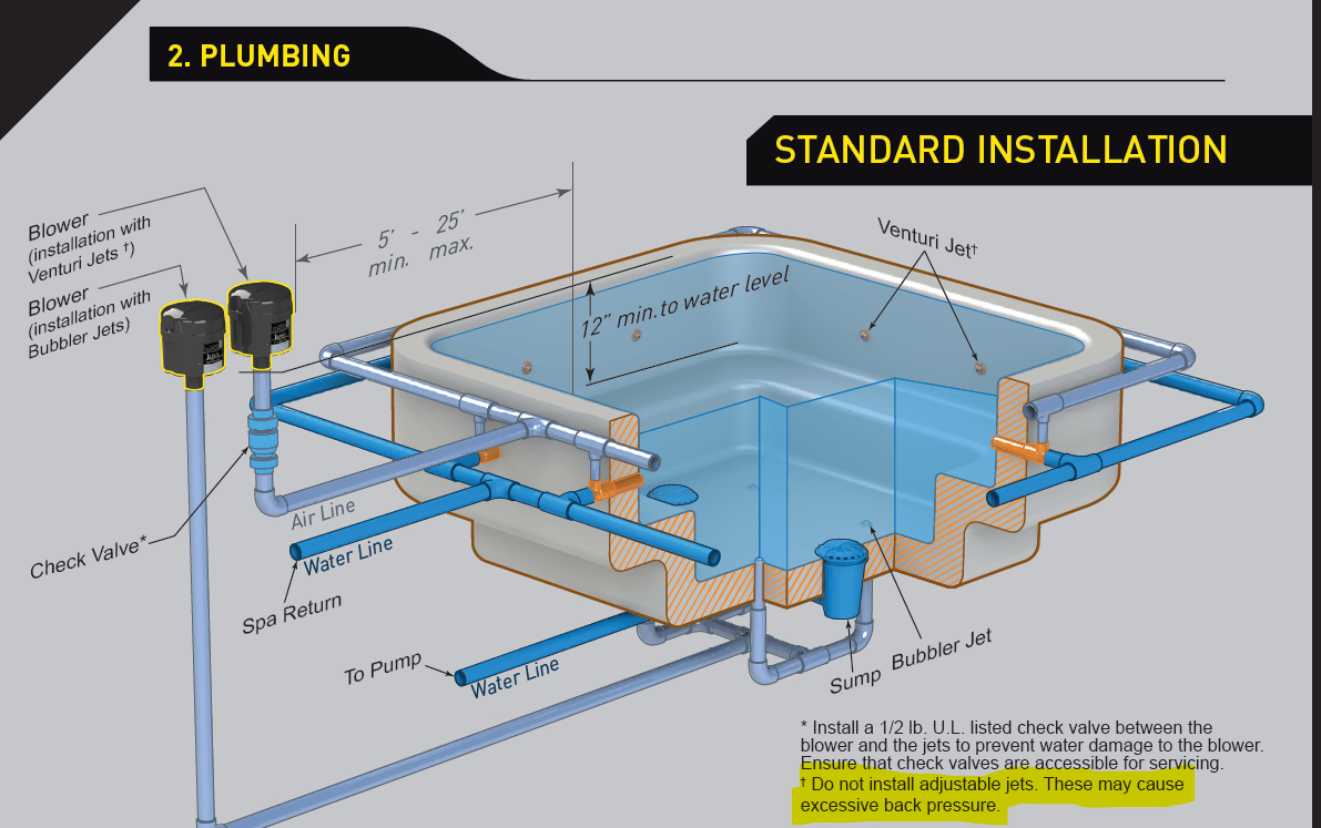

Spa Jets with adjustable eyeball fittings (spa only)
You going to have a spa air blower? - Yes.
Note that the attached Jandy Blower Installation Manaul says - "Do not install adjustable jets. These may cause excessive back pressure."
