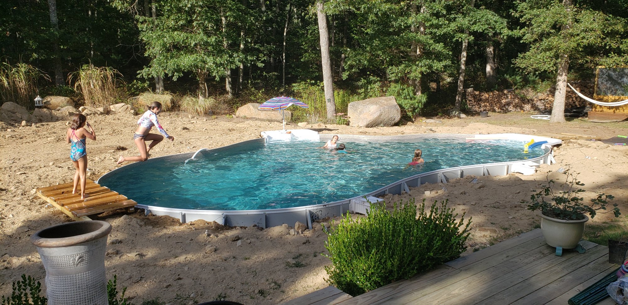

What is the shape of your pool?
Post some pics of your pool and the surrounding area so we can see what you are working with.
That's what I've got, looking out my upstairs "covid made this a home office" window. I'm pulling the cover off next week and the concrete guys are coming out not long after. I'm trying to decide if I should leave the water level low and run off the main drain during this process or if I should get it up to skimmer height to help keep the surface clean.

Yeah, there have been all sorts of issues with this builder. Too many to list. Most of them I've been able to remedy before they became larger issues. But some, like this coping issue, I didn't know to look for. Others, like them back filling with rocky dirt instead of the gravel I asked for, happened before I could stop them.
But, the good news is that none of that matters to the kids and their friends as evidenced by this pic from last summer...
