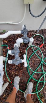

Thank you for the replies. Right now only the main drain is active. I really want the skimmer going because we don't have a pool cage yet and we have the most annoying tree dropping leaves everywhere. I just cleaned the pump basket which was incredibly full and have the pump continuing to run. Don't really want to mess with running the skimmer without the pool company here. Don't want them to say I messed anything up. Problem is it would help immensely. Just got as many leaves out of the pool as possible.
You don’t need a skimmer to add anything, specifically don’t add stabilizer to the skimmer even though the instructions sometimes say to do that. Use the sock method above.

Does the skimmer have a skimmer basket in it?
Is the water level about 1/2 way up the skimmer opening?
If both are true, turn the valve handle that is between the main drain and skimmer so that OFF is pointed to the right and the handle is pointed toward the pipe leading to the pump.
Just did this. Thank you
