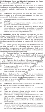

That junction box possibly doesn't meet NEC requirements.
Corrosion resistant? Looks like dissimilar metals.
Strain relief? Not apparent.
Water proof? Looks like open holes to the outside rear.
It would be better to use something similar to this:
NEC 680.24(A) and 680.24(B)
That box looks like a standard name-brand aluminum weatherproof box to me. Likely one of these:
Assuming Josh fits it with an appropriate cover with gasket it will be just fine.

Hi pro -- I agree. 680.24-A-1 states that it should be labeled as a swimming pool jbox. I installed a typical outdoor WP j box which by the letter of the code isn't allowed. Thanks for the amazon link. I followed it and found that I actually bought the attached (related products). Now i just need to find it in my garage!
Should be easy enough to disassemble what i have and replace.
