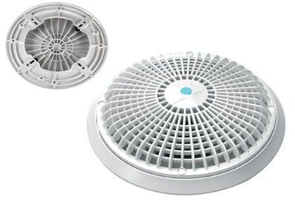

I have an in-ground spa attached to my pool with dual drains. The covers have broken and I need to replace. Am I now required to replace with anti-entrapment covers? If not any ideas the make/model of the attached cover pic? Thanks.

Anti-entrapment covers are all anyone sells in America, so yes. I have found a few here and there but I'm not looking for any of the old drain covers.
All new main-drain covers meet VGB standards. That doesn't mean the sump does, but residential pools don't need to, yet. I have installed many of these (including in my own spa):

Would this cover be anti-entrapment compliant or do I need the whole drain assembly - Seems like from what I have read it is the VGB replacement for what i shown in the pic I posted?
Reactions: Ignoramus
If the screw holes in the new Hayward cover match the existing mounting ring, then yes that is all you need. If not, you can drill new holes and put in plastic anchors and that will work also.
I like the retro-fit covers because they come with adapters and other parts that allow them to be used with virtually all existing main drains. You can find them by looking up that phrase, "retro fit main drain cover." The picture I attached earlier was just for reference. You would likely only need an 8" cover.
IMG_3254.jpeg That pool drain cover is the Hayward SP1048E hey where does not make that drain cover anymore and a good direct fit for it will be Hayward WG 1048E it’s a newer one to Hayward makes it’s a Virginia Graham Baker drain cover that were a direct fit and a good replacement for the old Hayward drain cover, and it only needs to be replaced every seven years
