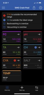

Ok I tested just now to 800. App says I need twenty 40lb bags of salt. Here are my current numbers attached just ran in the last 30min. What do you guys recommend? I know I need to bring my CYA up so I'm on that.

Not sure if anyone told you -- but do NOT use Clorox brand pool salt. It is known to stain the pool.
I use plain water softener salt. Home Depot, Walmart, etc.
