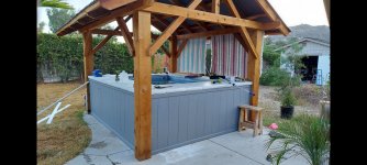

I ordered a cover from Beyond Nice on 09/03 which should arrive late October. In the meantime I am working on finishing the enclosure and insulation. I did a 1 hr. test and noted a temp increase from 75 to 79 °C and measured current at 1.3 A in filter mode and 33 A while heating. No surprises there. I pay 0.41 cents per kW hour so I am very curious how much heat will be lost through the uninsulated slab. I’m guessing a lot - so I’ve been looking into what it would take to incorporate solar heating and am keeping an eye on craigslist for a good deal.
I bought a bunch of foam panels to use for insulation but may instead use mineral wool. If anyone has any thoughts on that I'm all ears.
For the removable side panels I framed them out with 2x4s, used roofing tar paper as the moisture barrier, cement board for siding, and PVC trim for top and bottom. The paint is Behr elastomeric in “legendary grey.” The panels in the last photos are not yet bolted in, just propped up, because I grabbed the wrong size T-nuts from home depot and didn’t want to make another trip yesterday. To be honest I am not completely sold on how they look. I don't know what, if any changes I'll make, but I'll continue to mull it over. Redwood siding might be a good option.
