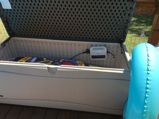

Speaking of the control box- do you have plans to shelter it from the elements? It isn’t waterproof (just water resistant) & shouldn’t be left in direct sun/ high temps for long. Many people have the power source under their patio or on the side of the house so they are able to accommodate it with shade/shelter while in use or better yet, most all the time with it running on a schedule.
Crud, I forgot about the control box. On one hand that's good, because I can hang the control box on my fence closer toward the middle of the short side of the pool and from that spot, I think a 60' cord will reach my entire pool. Just need to figure our some kind of shelter for it - a wooden box? A big fake rock?

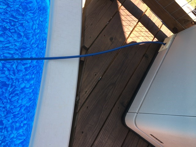

I have mine mounted inside a weatherproof deck box -
it’s not a perfect solution because when it gets really hot outside 90+ the temp in the box gets quite hot so i try to open the lid a bit when possible during the times it is hottest/ in direct sun. Something with more ventilation would definitely be beneficial in my case. Do a search here about robot storage/shelters for some ideas. There’s quite a few threads.
