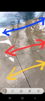

Well this did not work either. Water was running under the tarp and still pooling and running over. I would have though the 4x4 sitting on top of the tarp would keep water out from behind so my guess it is running from the side as well. I guess a have a slope issue as well and not just water pooling in that area. I am going to close the pool this weekend and put the cover on. Plan on ordering a new liner over winter and when it is installed I am going to silicone the liner track and then press in the liner lock. Any suggestions on this method or type of silicone to use?
That’s odd. The picture makes it look like the deck slopes away from the pool back toward the joint in the deck. Does that joint not run down hill parallel to the pool? If it doesn’t, then yeah I could see water pooling up there and getting under the tarp.
