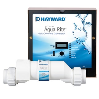

For a SWG only system you want…
Low salt caters to some localities that have put limitations on salt levels that can be discharged.
TurboCell is Haywards branding of their latest copied cells to try and get away from Chinese clone cells that are being sold.
There are two models. There is the one that @ajw22 posted. It's the model available from online stores and other places. Then there is the Hayward Aquarite S3 40k that is being sold through Hayward authorized dealers. From what I can tell, it's Hayward's attempt to keep sales through dealers and prevent third party cells. Replacement cells are supposedly only available through a dealer and not online. I did find one dealer selling them online.
