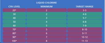

Yes you test and add daily. After a while you'll expect it to be X everyday, and you'll be right more often than not. Then you can just add the inbetween dose without testing every other day or double dose and skip a day. Ironically, paying more attention to start makes for much easier pool care later.
The chart above, nor our belovedPoolMath, doesn't know you are losing 4 ppm a day in July, or 1 ppm a day in November. It's up to you to add these up :
Minimum FC +
Your recent daily loss +
1 or 2 FC wiggle room
= Trouble free pool
You will dose so that you are still free and clear above minimum at the next test/dose time. Minimum sounds way to OK for my liking. It's lava. Don't touch it, don't breathe it, don't get closeup selfies. You will be burned.
Keep us posted and we'll help. :)
