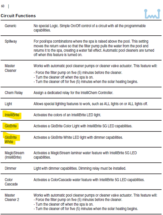

What circuit function is the Watercolor light AUX circuit set to?

So, the CMP Natural Wonders are a "J" Style and NOT a "P" style correct?
J style is or Jandy Aqualink Controller.
P style is for Pentair Controllers.
The style is selected on the Smart Synch Controller.
I think if you set the Smart Synch controller to P-Style and say in the Circuit Type it is one of the Pentair color changing lights then you will get the color menu and the IntelliCenter will do the on/off clikcs for you.

Do you have the CMP waterfall lights connected through the Smart Synch controller box? If not, that is what you need to make it P-Style.
