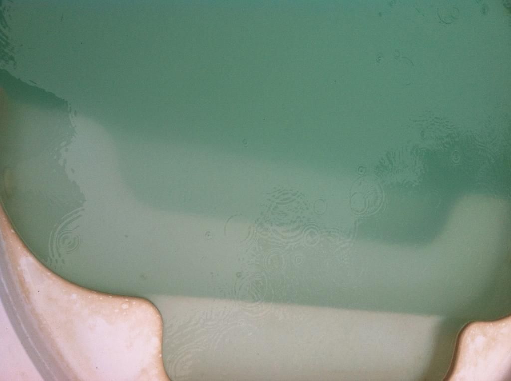

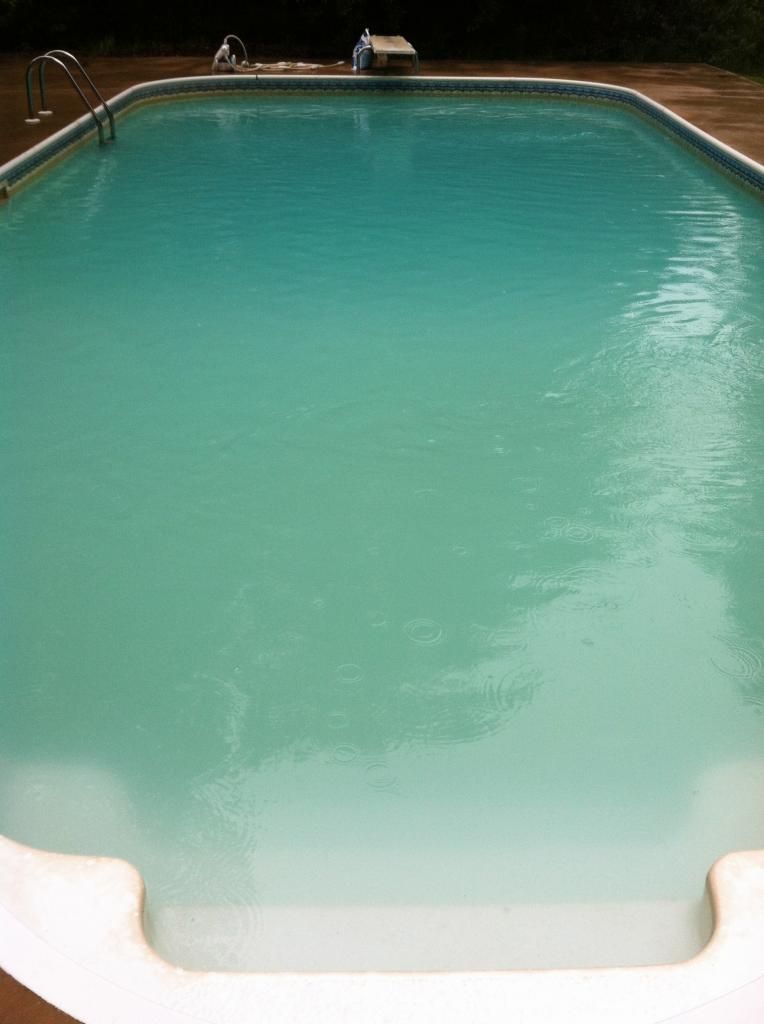

Day 25 update: It has been raining here for many hours and the pool doesn't look as pretty today. The DE has been in my filter for almost 24hrs now and the psi is up from 17 to 24!! When should I backwash and add new DE?? As you can see in the pics..... the 3rd step is visible AND the 2nd step on the ladder!!!
Now. If clean pressure is 17, you should be backwashing at around 21 or 22 psi. Don't forget to add more DE after the backwash.
