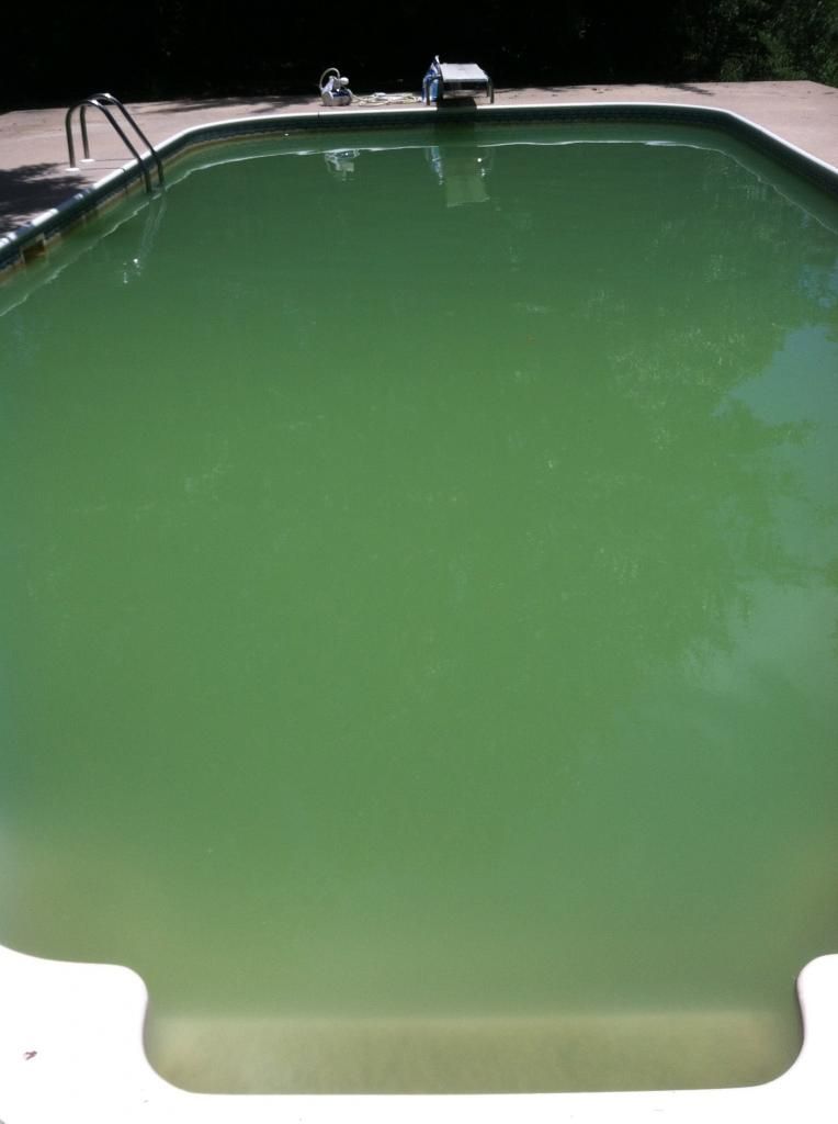

Day 8 update: I'm keeping the SLAM FC level up to 19 now (with the new pool size calculations). Overnight dropped from FC 21 to 13.5, but I was about 2 hours later than usual when I started testing. Maybe I'm overly optimistic today, but it does seem a lighter yellowish green. I brushed up a lot of brown junk. Day 8 pics:

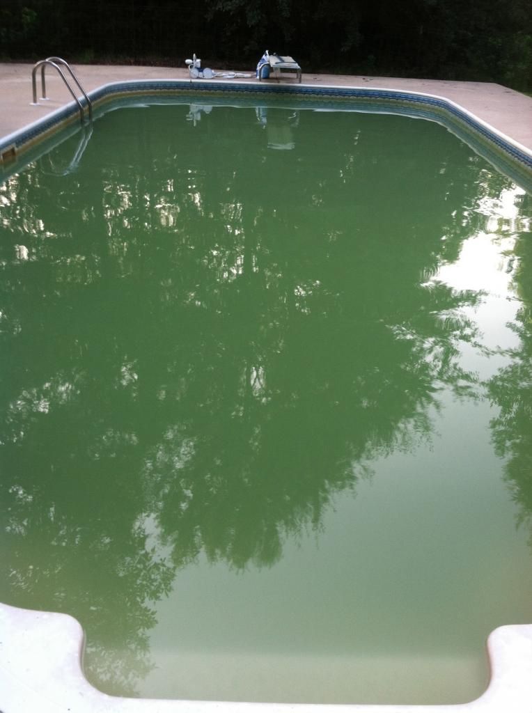

Day 9: Wednesday is my day to babysit grandbabies during the summer, so I was out all day & I'm late posting. I was successful in keeping up the higher FC none the less!! Last night at 9:30pm was at FC 20 & this morning at 6:30am was only down to 17!! Pool Math said add 81oz. to get back to 19 but, I new I would be gone all day, so I went crazy & added 2 jugs!! I don't know how high it went up during the day today, but when I tested again at 6:30 tonight, it was at FC 17!! CC is 1 - 1.5 (not sure if it went clear on the second or third drop). Day 9 pics:

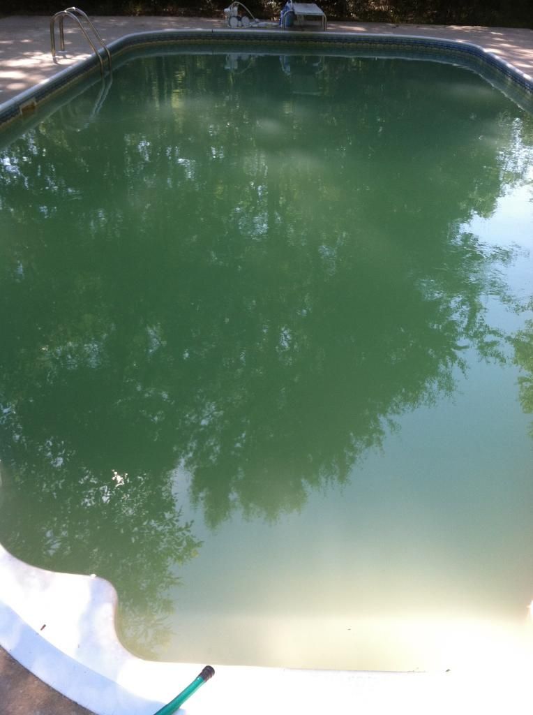

I am keeping SLAM FC level up to 19 successfully, consistently losing 2ppm overnight. At FC 17 again this morning, adding a little water today, it's been very hot & there is some loss to evaporation. Brushing & running polaris. Day 10 pics:
Hey...... Is that blue in my pool !!!?????? YES, blue sky, NOT blue water :(

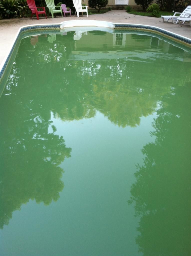

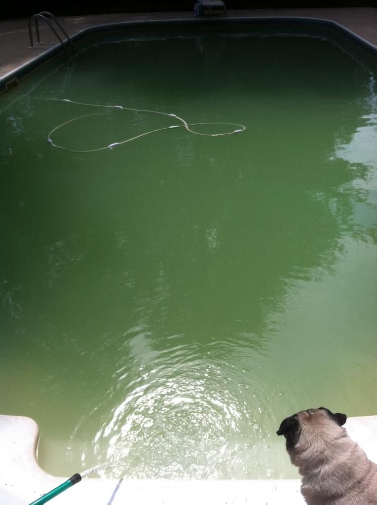

Day 12: The pool's chlorine consumption has drastically decreased, only losing .5ppm overnight!! I'm hoping we (the pool & I) have turned a corner in this battle:D As you can see from the pics.... still green, but much lighter than 2 weeks ago! Day 12 pics:
