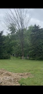

They delivered the walls, steps and other parts! PB said he was planning to dig Monday but it’s looking like rain most of the early part of the week so he may be delayed a bit. My dad and I cut down a bad tree today and I’ve relocated some shrubs that were in the way. It’s getting real!

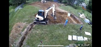

PB delivered the equipment and some supplies today as well as confirmed our layout. Dig is scheduled for next Monday and he expects to have the walls and rough plumbing in by the end of that week.
