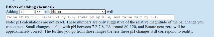

Before using trichlor, add the equivalent amount of weight in baking soda (X 1.15) to the pool to offset the expected pH and TA drop.
For 7 trichlor tabs (49 oz.), add (49 x 1.15 oz = 56 oz) = 3.5 lbs baking soda to the water to offset the acidity.
