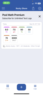

Hopefully this is the final SLAM for a while!! I think I got it right this time. This is the clearest in 2 years of owning the pool. Thanks for the confirmation.
Did you pass the OCLT and CC tests as well? Mind posting your most recent test results and telling us your post SLAM plan for chlorine?
Hopefully we can make sure this is your final SLAM ever.
