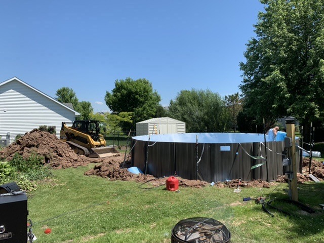

For the wall — when my pool was first put up, my installer put a bunch of those metal posts like that you’d attach fence wire to around the perimeter of the pool. Then they ran a strip of duck tape from the top of the pool wall to there, to keep it upright.
