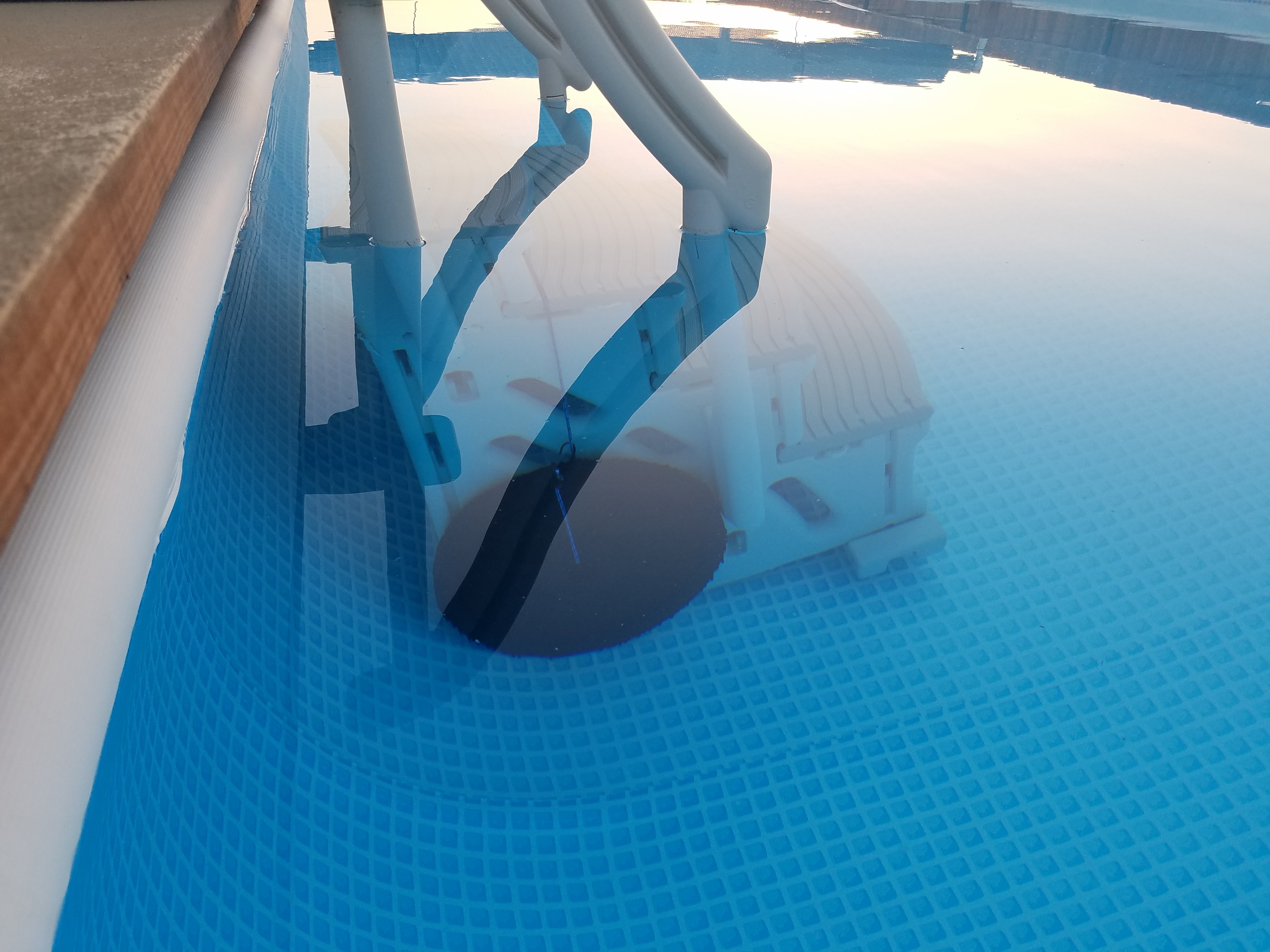

Thanks for responding. The coping is brand new - it was installed this summer. It's grey colored, powder-coated aluminum bullnose coping. my only pic is cropped from another photo from the construction phase - not sure it helps you much but I will attach.
After searching the forums here I have learned that there is concern for aluminum specifically with SWG and there are a few threads regarding pitting on aluminum coping with SWG pools. I'm hoping to find a way to make it work with both somehow.

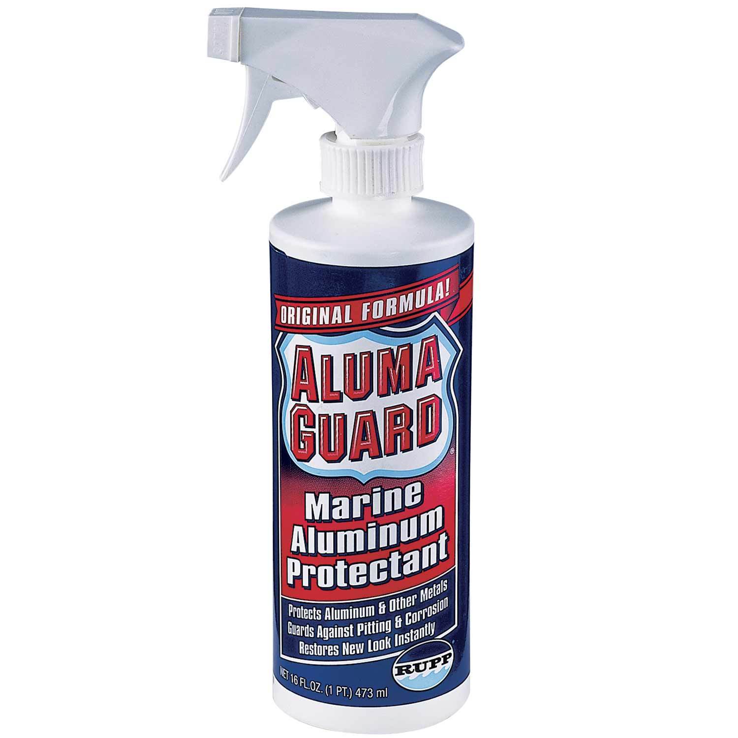

Thanks Steve. Yes, in hindsight, I wish I could go back and possibly make some different decisions there, but it is what it is now. I came across this item, I am wondering if just a little of this rubbed on the coping may help (especially as you point out the salt ppm is really not very high) or if I'm forcing a square peg in a round hole here.

No, I wouldn’t use that. That appears to be primarily for unfinished metal or aluminium surfaces. You have a painted surface however they do say in the Q&A section that it wont damage painted surfaces. They advise against using where a slip hazard may be an issue - not for floors. I cant tell if its oil based or silicon maybe but I would be worried about it washing into your pool.
This is a generalisation for marine coatings but they tend to be formulated to be flexible rather than durable
