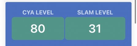

This is harder to accomplish & more expensive at such a high cya level. At a cya of 80 that means getting fc up to 31ppm & keeping it there until you pass ALL 3 end of slam criteria as listed in the article.
Even getting cya down to 60 would help your slam efforts & subsequently dilute some if the bromine as well.
