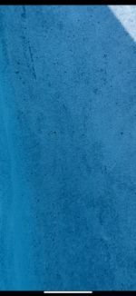

Really seems to be located only on the horizontal of my steps, on one side of the pool. its odd.Walls and floor?
Completed. I haven't had any issue in years, I am very OCD about balance. Being that its on the west side of pool and horizontal it leads me to believe something blew under the cover and settled on the steps. Something that a pumice stone and acid under water wont touch.What is your pool type? Please fill out your signature.
I scrubbed with brush, pumice stone, and nothing… haven’t tried a wire brush yet, didn’t have oneCan you scrape off anything from the spots?
I just watched a couple black algae videos, looked just like what I have. They crushed up some tri chlor tablet and it seemed to work, I may try that, pretty easy to tryPick at the spots with a wooden BBQ skewer and grab what comes out. If you can pick it out then it is probably Black Algae.
Thanks! I should have done my research before I posted.
