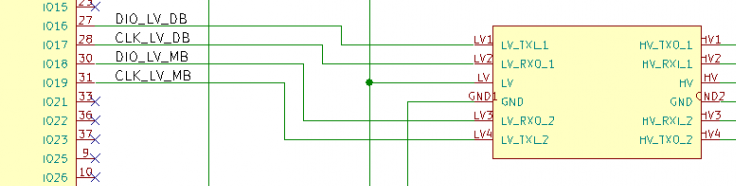

Updated schematic, with labels for clock and data lines swapped. Labels renamed to DIO / CLK to match Intex naming standard
Swapped +5V and GND on the Intex connectors.
It might be that the whole connector needs to be reversed? (Easily fixed by rotating the connector, if so)
Looks like the connector has a little dot on GND on the picture, signifying pin one?

Schematic:
EDIT: See below for updated schematic

Ok, I've dismantled my Intex SWG, and connected everything together. Still no response from the main board, or lights in the display board. I've verified that everything is connected correctly.
I'm starting to wonder if my controller board uses a different LED controller than the one used on on the board that @tonyflores1006 has. He has a board with a electrolytic capacitor on front, mine is without that capacitor.
( I've got the same board as @jressel01 )
The TM1650 is a 16 pin chip according to the datasheet, on my board there is a unmarked 18 pin LED controller. I'll have to look into what kind of chip that is, and if it makes any difference at all for the ESP32 code
Dismantled my Intex sandfilter pump, which _does_ have a TM1650 on the display board. Unfortunately it appears that the pins for 5V and GND are reversed on the pump, which explains why I had the connections reversed in my first schematic design. Need to update the schematic/pcb with some jumpers.

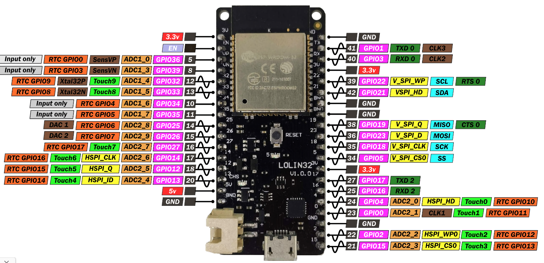

So I'm looking at my version of the ESP32 that I have (Known as the Lolin32)
proxy.php?image=https%3A%2F%2Fwww.electro-tech-online.com%2Fattachments%2F1652416286050-png.137070%2F&hash=6e702f492df36a5f343b13cd8ebf6b15
And looking at the schematic I see they call out GPIO 16, 17, 18 & 19. However, I do not have the same pin layout as they do...Go figure...
- GPIO 19 -> SWG main board clock
- GPIO 18 -> SWG main board data
- GPIO 17 -> Display board clock
- GPIO 16 -> Display board data
proxy.php?image=https%3A%2F%2Fwww.electro-tech-online.com%2Fattachments%2F1652414673058-png.137068%2F&hash=23220865d17cedaa65a90487d61b7484
So, I take it my layout would be:
ESP32 DevKitCESP32 Lolin32
GPIO 19->GPIO 19 (MISO)
GPIO 18->GPIO 18 (SCK/CLK)
GPIO 17->GPIO 17 (TX)
GPIO 16->GPIO 16 (RX)
That look correct?
