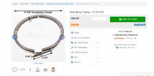

Your clamp is missing the spring. That might have contributed to the cracked housing by over-tightening of the band. You might get away with some epoxy if tight right now.
The knob broke and since we've been here, almost 7 years, there never was a spring on that band. Just the the large one on the DE Filter. Why they decided to use brass on a stainless steel bolt is mind boggling! The brass is softer metal and more open to stripping. I pull my filters in spring and fall and backwash one a month.
A thumb knob will ensure no one can overtighten, and the band can still expand on temp change. A lot of damage can be done with a wrench and nut, as the band can easily be taken over limit and past limit of the plastic. Would not surprise me if why others have experienced similar cracking in that area.

Most folks never realize the tension they are applying. In some applications, we did in fact have mandatory torque specs on clamps when I was in the field. Seating of everything is important. Temperature of parts being clamped together at the time can factor. A turn too many that can't be felt on the end of a wrench, as you previous used a short wrench but this time used a longer one or a ratchet, is where thumbknobs and springs help. If you leave the spring gaped, you are probably within acceptable range. Longitudinal cracking at the clamp lip base is pretty tell tale of over clamping force.
There was never a spring on that clamp. Those are on filters only. That pump has stood the test of time, despite some thinking it is a bad design. I have a customer with one about 30 years old that I recently put a variable-speed motor on with just a new seal, O rings. Your pump has handled millions of gallons of water and flexed hundreds of thousands times. Pre-98? Near 25 years? Good long service life. Should only need this part to be good. Can't be repaired.
