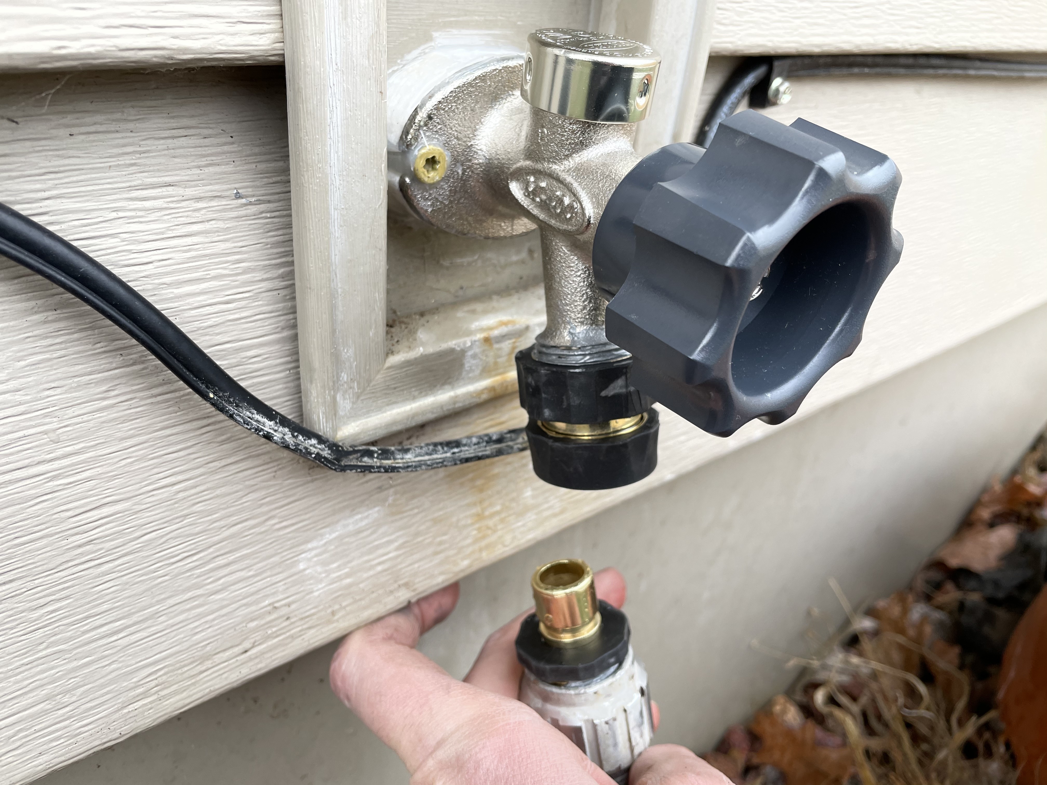

Frost-free faucets. This is the default up north where I am. I need to top my spa off every week or so for evaporation from a cover in bad shape (new one on order but I waited way too long to order). Just filled up my spa last night from an outdoor spigot yesterday in below zero F temps. The house mounted spigot has the valve 12” back from the handle, well inside the basement. No freezing even with the -15 °F we’ve reached this winter. When shut off with no hose the remaining water drains out due to a small slope. I’ve got a quick disconnect to attach the hose too the faucet to easily disconnect once done. I drain the hose after and leave it outside. Been working great for over a month now!
