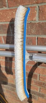

As you know, I aborted (really postponed) my treatment for a few days. The reason I think I have a problem is that the base of my pool brushes and the brushes on my pool blaster are turning brown. It looks like after repeated cycles of drying, that something stains the brushes. The screws in the brush are not corroded. Does this look like staining from iron in the water?

My brush looks like that - i can only assume there’s metal on the inside that pinches the bristles to keep them in place. Have u had your water tested for iron?
Take some vitamin C tablets, put them in a bucket of water, and put your brush or other stained items in the bucket. If the discoloration is iron, it will quickly be removed in the bucket of water.
