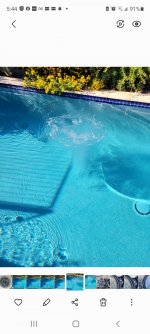

A lot of bubbles coming out of the pop ups and returns

ok. still have problem.. the leaf canister must be this. could leak come from here? here r some pics of bubbles at start up. got extra air out of filter after these pics

I think lots of air. at start up I was here at canister. lots of strong bubbles at canister which make me think air started closer to the pump

I mentioned the SWCG above. Those are small, champagne size bubbles. Maybe a picture of what you are seeing may help.
Air can only get in the system with the pump running on the suction side. If the air is only when the pump starts, that can be from a leak, typically in your filter system (oring, air release, etc) that lets air in when the pump is off, but does not let water out when the pump is on.

they look so much more ikea champagne bubbles in oic but r so massively loud and I think bigger than seen in pic. I've had small amounts of champagne bubbles before. since it started once when we were overdue in cleaning pool and dirt was on bottom I felt a stone must've gotten pushed into plumbing or something.

What you are showing is continuous when the pump is running?

I shut pump off for a few min and they came out like champagne but I think this is just cuz pool only off 2 or 3 min. first thing I noticed this x was about 1 or 2 extra pop ups were up at same x then went back down. that makes me wonder if there is a pebble somewhere but they went down less than a min. the bubble only last prob 30 seconds. I see a leaf on bottom blowing from pop up like it should. while I write it's now running good while on for a few min

If the bubbles are only when you start the pump, look at the filter air release. When the pump turns off, do you hear air or gurgling in that area.
