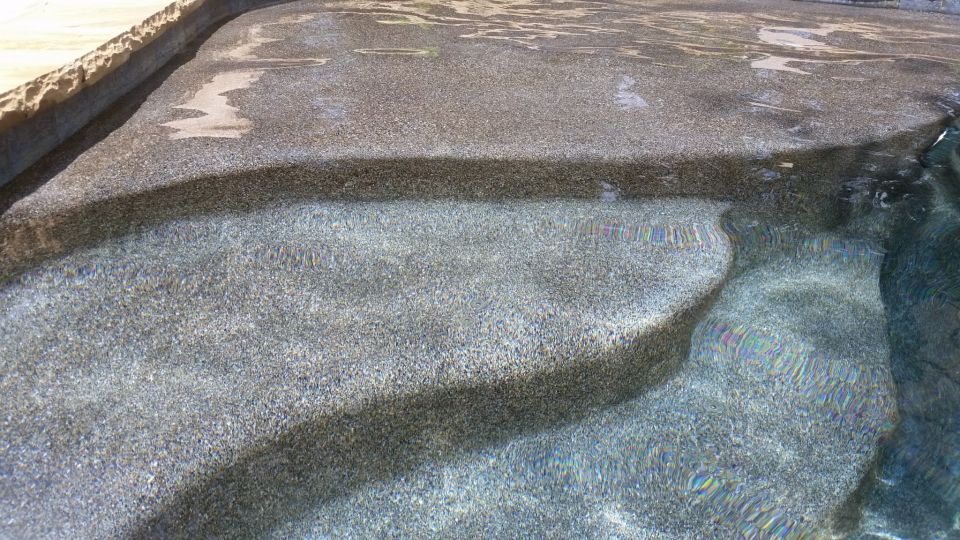

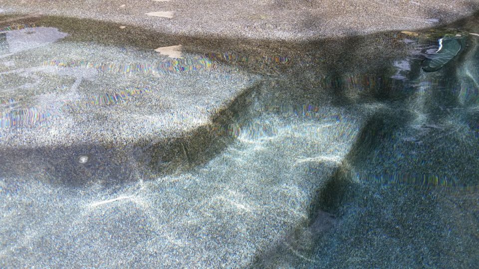

Fading Plaster
We've had quite a few discussions recently about plaster fading. I mentioned that my horizontal surfaces have faded much more than my vertical surfaces. I noticed the other morning that it looked pronounced at the steps and took some pics. The vertical surfaces face northeast and are partly shaded in the morning by trees and are shaded all afternoon. The steps and sunshelf are full sun all late morning and all afternoon until until between 5p and 6p. This is black onyx Pebblesheen installed in 2012 and maintained TFP style with SWG since day one. Don't try to notice the difference between the sunshelf surface and the step treads, they look the same in real life. Something about the angle or something makes the sunshelf surface look darker than the steps for some reason but it is not. They are equally gray. The point is how much darker the vertical areas are than the step treads. This is how the entire pool is, more so on the north facing pool walls.

I know you went with a dark color, but would you recommend going a few shades darker than one would like knowing that over the first 10 years (hypothetically) the average darkness would be what you want?
Or just tell them to get Aquabright and hope the marketing language on not fading is accurate?

We went with the darkest shade available. The plaster was jet black when it was installed. It is light gray in the worst spots now.
Good question, what would I do now?
First of all, we were on the fence between black onyx and whatever the sheen version of tahoe blue is to start with so we don't hate it. Tahoe blue is a medium gray plaster color.
I would definitely recommend aquabright if you can find a good installer.
Otherwise, I would recommend a medium gray quartz finish. Since that is what you are going to end up with anyway. No reason at all to pay extra for darker colored plasters, especially the blue ones. In 2012 all of the blue plaster were a $1000 upgrade. We considered it and boy am I glad we didn't waste that thousand bucks! The black onyx wasn't an upgrade.

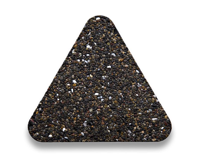

Here is what black onyx looks like the first day according to the PebbleTec website.

Hey pooldv, I wonder if you brushed these areas if it would blend back in. I have been very bad:(about brushing or perhaps too lazy:(and often wonder what are the pros and cons of not brushing. Our pools still has some mottling (which we like) and over the years more and more pebbles show up which makes it look more uniform.
Re: pooldv pool thread
It is likely that I could lower the CSI to -0.8 or -0.9 and brush a lot to expose a new layer of black plaster. Or do a zero alkalinity treatment and brush a lot. But, that would just remove plaster and shorten the life of the plaster and in a couple of years the gray would be back.
