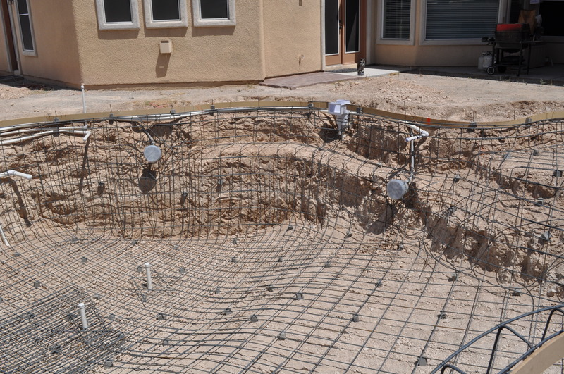

This was by far the most fascinating phase for me. These guys worked their butts off today and so far this has been the least expensive phase. Guy told me he put over 1 ton of steel in my pool. Sorry for the number of pictures, I just really liked their work:

Why is there the extra steel on that one place? I think it is by the spa.
Actually they're raised planters and the engineer had to put extra steel there because it's over 8' total.

Did the steel issue get resolved? What was the problem?
Sorry, forgot to update this thread, I started another diving deeper into the issue.
Yes, it was resolved, steel guy came out first thing the next morning and added the steel. Honestly, I think he under bid it. He put the extra/larger steel in the area that was over 7' as he'd seen on other projects not thinking (when he was bidding) that it would be required around the entire deep end based on the other probably thousands of pools he's done. Inspector agreed with structural engineer and failed me. When he came back he told me he was losing money on the job. Felt badly because I'm not out to screw anyone on my building costs, however, he had all the information including the structural engineers plan when he bid.

My steel guy missed the notes from my engineer that said "6x12 on the vertical". When I went to inspect at the end of the job, I asked him where they were (he had done 12x12 for the whole pool). Should have seen his face. I also felt bad, but it was in the bid sheet and I wasn't about to be failed for it.
