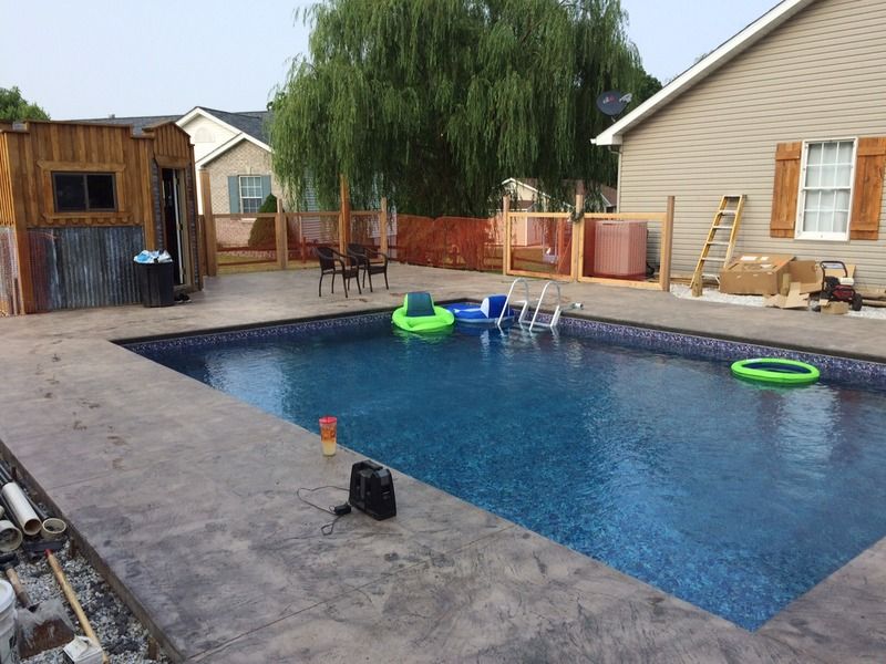

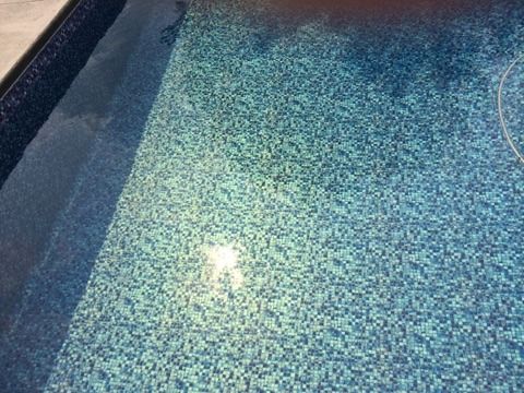

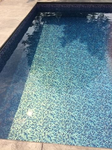

Lots of work to do yet but got the pool opened and running this weekend. The liner is from Loop-Loc and the color is "Luminous Soul", also bought a Polaris P955 robot and it seems awesome but I have nothing to compare it to as this is my first pool.

Wowie, Wow, Wow, Wow! Your liner makes it look like an all tiled pool!!! Or am I not seeing correctly? That is my dream pool! I've never seen a liner like that. In my next life, I'm going to have a vinyl pool with THAT liner (at one of my homes - LOL!!!) Does it really look like that bottom photo when you're looking down into the pool? It looks like those million dollar LightStream all glass tile pools. That's amazing. And looking at a distance the color is gorgeous. Hmmmmm.... I wonder if I still have time to tile my entire pool. That would certainly take care of my whole Pebble Sheen color dilemma! Oops, forgot - I'm all out of money!!
You guys have to be thrilled and have such a sense of pride in your accomplishment! Bravo! Hats off to you! Keep the updates coming! But you could stop here and have a fabulous pool!
Take care. Suz.
You absolutely nailed it Pipe Rat. That is a magnificent pool. DIY just makes it so much more satisfying.
You are a credit to your craft.
Enjoy it.

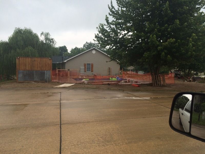

I would love to see a pic from the street to get a feel for how the pool and building sit by your house. I would have NEVER thought to put a pool out front by the street. FUN TIMES for all in the hood!

Thanks for all the compliments everyone. Still lots of work to do but I feel we have achieved a major milestone by getting the pool open. Yes Suz you are seeing correctly, the liner gives the appearance of an all tiled pool. We had our fingers crossed going so bold with the liner but are both very pleased with the look.

As for the placement of the pool, we have not got a big enough back yard or that's where it would have been located. Everything is a compromise. We have a very wide lot that goes court to court (so no other houses 10 feet away) but with that we got a small backyard. My fault....the wife wanted a 3 acre site and I didn't think I wanted to take care of 3 acres so I found this 1/2 acre one to build on. Hindsight being 20/20 I should have listened to her but alas we still have a place we are proud of and I am not moving ever again, the kids can worry about what do with it when we're gone. LOL
There will be portions of privacy fence where needed and the rest will be 60" tall black aluminum fence. We considered all privacy fence since we are in the side yard but didn't want to feel boxed in or hide all the beautiful handy work. he he[URL=http://s693.photobucket.com/user/vgputility/media/Pool/Pool%20street%20view/IMG_3026.jpg.html]

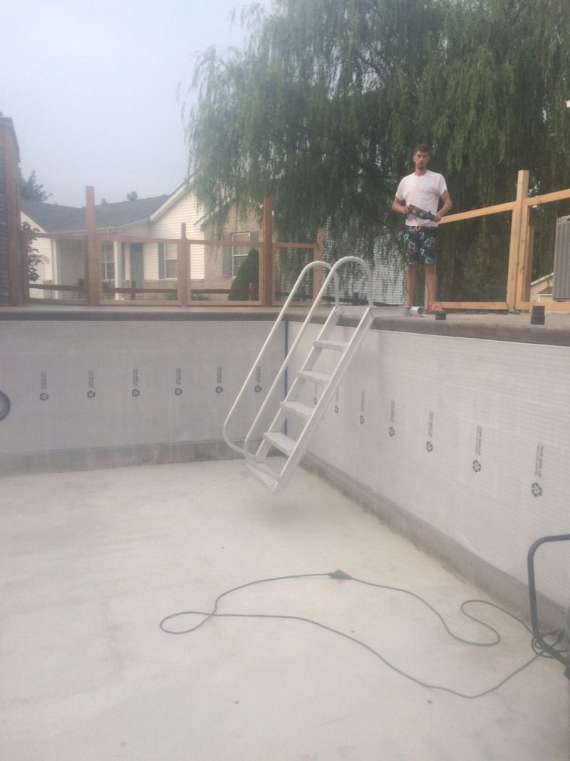

It looks as if it is but just verifying - is the blockwork drystacked? Going to begin my own build soon and currently debating between a block or poured wall setup. Any tips on doing the drystack if it is in fact drystack?
I chose the concrete block method because I didn't have the skills or the equipment to pour the walls. Looking back I probably could have rented the forms and figured it out but I felt more comfortable taking my time and this method lent itself well to DIY. I set the first course in mortar and paid special attention to getting it level in all directions. After all that I found that dry stacking still becomes a little less than perfect the higher you go so on I think the 5th or 6th course I used mortar once again to get everything perfectly straight and level prior to the bond beam. I installed rebar vertically in every hole (overkill) in the blocks and horizontally in the bond beam filling all spaces solid with concrete. I also tied it all together and electrically bonded it.
I followed some guidelines from drystacked.com. Good Luck with your build.
