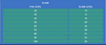

*If your cya level is really that high you’ll need to replace some water as it is impractical & very expensive to attempt to reach/maintain shock/slam levels as high as are necessary to eradicate algae as you can see from this chart 👇

Slam level for a cya of 90 is 35ppm.
This can get very expensive especially with liquid chlorine being $5+ a gallon.
