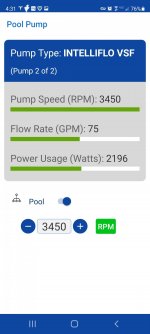

Ok Here are my readings for running for a few minutes at 3450. Also, filter pressure.

The plumbing curves for these two speeds (3450 vs 1808) is very interesting.
Plumbing curve @ 1808 = 0.03
Plumbing curve @ 3450 = 0.016
Normally, plumbing curves do not change much with speed. However, when there are spring loaded devices such as check valves and bypasses, this can happen. But the 1808 RPM curve is almost double that of the 3450 curve which is very significant. So this may explain the higher than normal RPM for 30 GPM. But even at 3450, the plumbing curve is double what I would expect from 2" & 2.5" plumbing so still excessive but certainly not as bad as the lower speed curve. So given these results, my conclusion is the HP is causing a significant amount of head loss at lower RPM and the bypass could be causing excessive head loss at higher speeds. Given that there are unions on the bypass and heater, how hard would it be to make a separate bypass (pipe only) for some testing just to confirm that it is those items that are causing the higher head loss? It might be worth the effort to just confirm.
