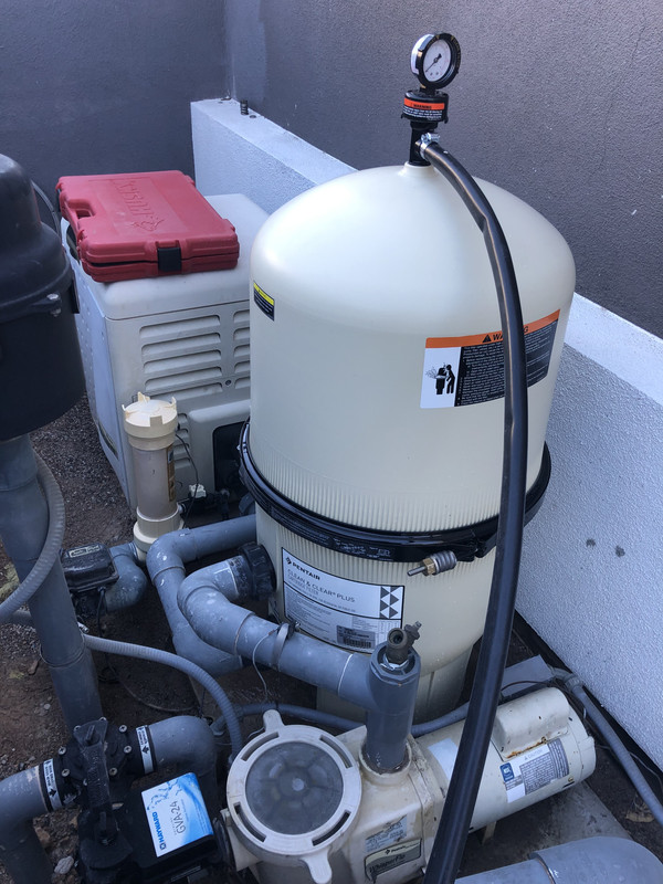

I recently had my Pentair Clean and Clear 420 cartridge filter catastrophically explode. It was about 8 years old.
I was checking on a leak in my pump.
Pumps had been operating that day.
I turned pump off.
I turned pump on.
No issues.
I went to turn pump on one last time and when I hit the button a loud boom!
I shut down and the filter bottom had split vertically from the band all the way underneath.
It almost split completely in two. Luckily, the top didn't separate and kill me.
Anyway, I got my new Pentair C&C 420, brand new from the factory yesterday. I installed it in the exact same way as the old one that blew up. I went to fire it up with the air relief valve open. As soon as water came out the valve I noticed that the new filter was leaking water from the band. This is before shutting the valve. I immediately turned off the pump. I noticed that one of the springs was not touching so I tightened the band. I tried again and same thing. This time I watched the gauge on the valve. The pressure hit 30psi and vibrated there. This was with the valve open. I never shut the valve because the band was still leaking. 30 psi is about normal for my system but with the air valve shut not open. Now I am completely freaked out that the new filter is going to blow if I shut the valve. Some questions.

OLD FILTER THAT EXPLODED

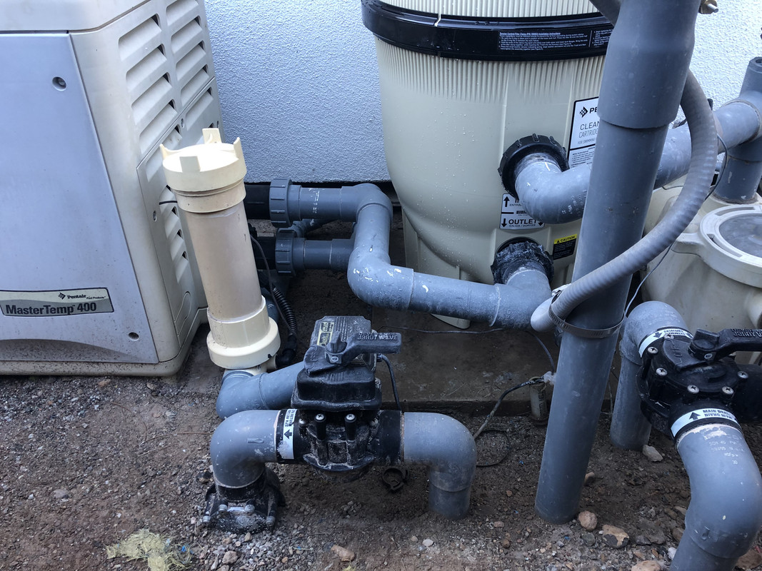

Oop's yes. I didn't state the part(s) btw the filter/heater and chlorinator, which obviously is the ck valve...these are usually right btw the chlorinator and heater to prevent strong CL from backflowing into the heater...from the pic's I cannot see the ck-valve; is it at the back on the turn?
The bottom union of the heater is the outlet. Coming out of the heater outlet, the line 90s back towards the wall and then does a 180 to head out towards the pool.
Standing where the heater is, facing the filter, the outlet turns left 90 degrees, then another 90 left and down then another 90 left to go towards the pool.
The check valve is just past the first 90 out of the heater.

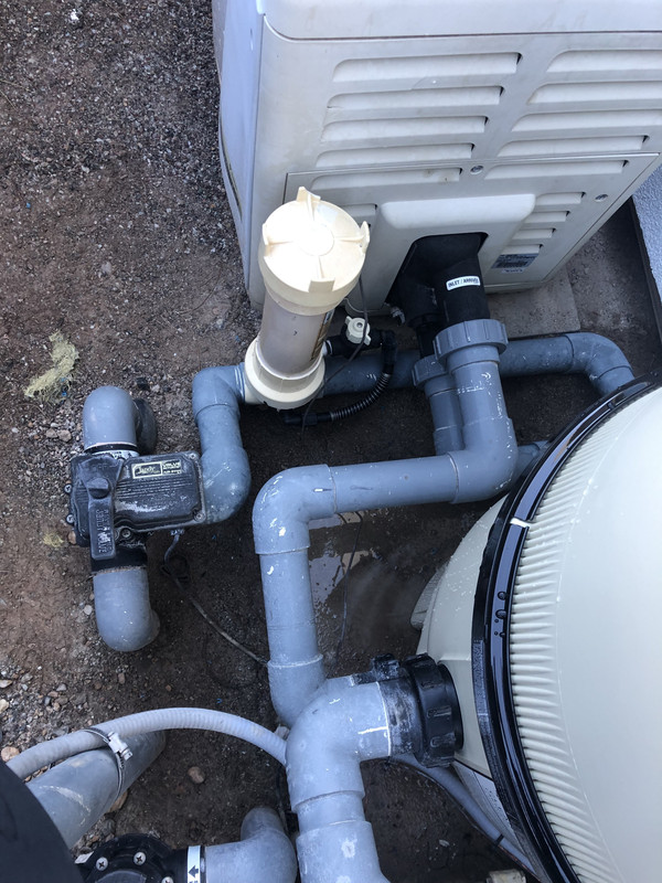

I took off the top <filter outlet> to <heater inlet> pipe. Looked clear.
The pipe from the outlet of the heater to the valve is on the bottom. This is the line that has the chlorinator and the flow valve. If I am understanding you right, this flow valve is only needed if I use the chlorinator to protect the heater. So, I like the idea of removing both. The problem is that this line of pipe is all glued slip fit connections, except at the heater. It is also painted.
The way its connected there is not much pipe to work with. It would seem the most efficient to go from the heater outlet 90 to the right and straight into the valve.
Am I not seeing this right? I do have to cut and clean and re glue all the bypass components required to remove the chlorinator and flow valve?
How do I get the pipe inside the valve out (right now there is no clean straight pipe coming out of the valve body, its right up to a fitting)? Is there any way to repipe from the valve to the heater without all new valve body?
thanks
Pipe that needs to be replaced to remove chlorinator and flow valve. Under valve (left in picture) the 90 elbow sits almost flush with the valve body. It seems the absolute minimum straight pipe was used to get the elbow on. Can that be removed and new pipe put in the valve body or do I need to replace the entire valve body?
Proposed new route in green if I can get a new pipe into that valve body.
