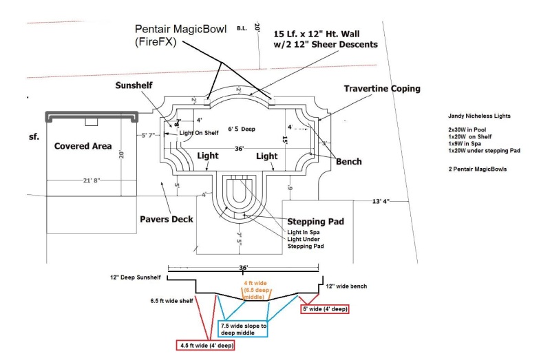

Here's a design we've developed with our PB. The pool will be centered on the living room. The room to the right is the master and we may add a door to the spa area. Yes the spa has a mini moat around it. We will be adding an additional covered Patio and since the back of the house faces west it will have a wall on the far end. The sun self will need to be a little larger and we want to add some type of jumping rock on the left side. Lots of deck and we may go with travertine pavers but I found these concerte Pavers by firerock that I'm going to research.

Hello SpringPool, I love the design, very classic. The view from the inside is going to be beautiful too. The one thing you'll want consider with the pavers you are looking at is how hot they will get in the sun. Concrete tends to get hotter than travertine in the sun, so you may not to ask the manufacturer about that. Congrats on the design. I can't wait to see this build.

Thanks everyone. After reading up on pool lights I'd like some suggestions ideas. Originally I was going to put led bubbler lights on the sun shelf but the reviews of the lights seem to indicate they break easily.
What other options are there? Should we just place 2 lights in the pool and not worry about the shelf it's going to be 12" deep.
I've also looked at the jandy nicheless and think 3 in the pool and 1 in the spa could work and am also researching the S.R. Smith Treo lights.

I have 4 globrights in the pool and one in the spa and just turned them on and can tell you it's perfect. I added one in the shallow end in the steps and I have no dark spots.
I would highly recommend you put one on your shelf so it's not dark. Read through nursenini thread and you can see she said her shelf is dark

im now leaning toward 3 20w jandy nicheless in the pool and a 9w in the spa. Has anyone used the 30w version? Are they significantly brighter? The design then has 3 9w around the spa in the moat.
Next question is more on preference. Reading other posts I think I want to start the pool at 4' and go deep from there. What are the thoughts of 4' 6.5' 4' depth. For those with the deepend in the middle how does jumping in work? Any cons to having the deep end in the middle?
