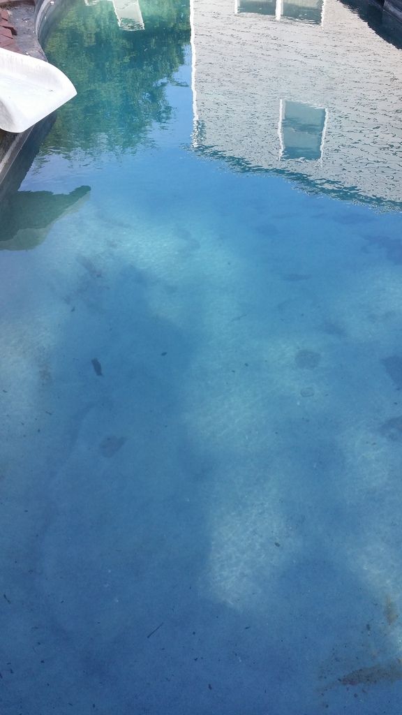

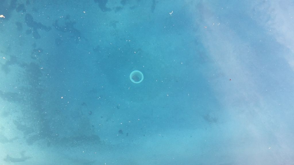

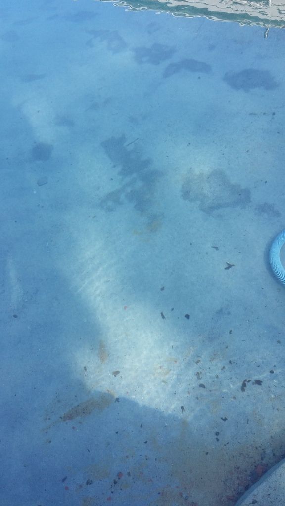

Do you have a new picture to show us? :)
So I took these photos before finishing up brushing and more vacuuming so I'm about 99% cleaned up. I lost a lot of water to waste but replaced it but the fc dropped from 14 this morning to 9 after losing all the water but I put more in. Not sure if I should be doing any other tests besides fc or cya or that comes when slam is done
For OCLT, if the water looks good and clear and you feel you're near done the slam, you would add to target, say 17 ppm since your Slam level is 16.
You'd test the FC (after sunset, because you will always lose FC in sunlight) - lets say it reads 17.
In the morning, preferably in dark before sun rises, you test the FC again. If it is 16 or 17 and the cc reading is .5 or less, you've "passed" the slam.
What the test shows is an absence of chlorine loss in the dark of 1 ppm or less. Then you know there's nothing left to "kill" ;)
