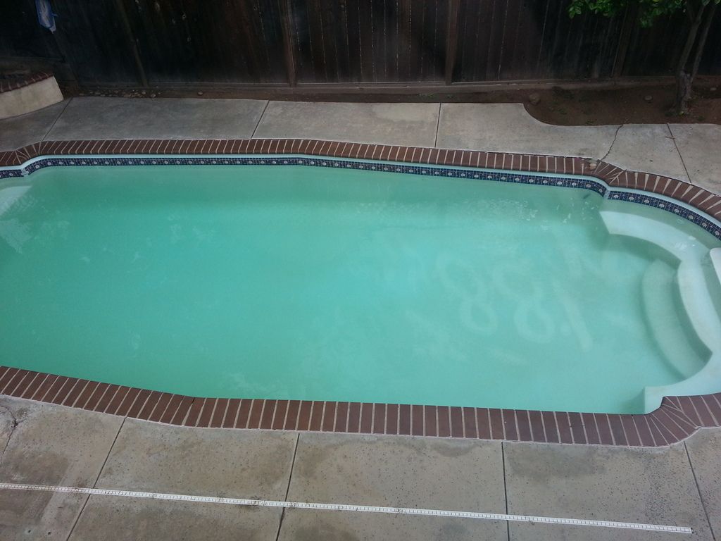

Do I see a 188 or an 881 in that pool?
Umm... That's really weird... I see it in the picture too but I've never seen it in the pool and it's not in the other pictures either. I'll have to take a closer look when the water clears up.
