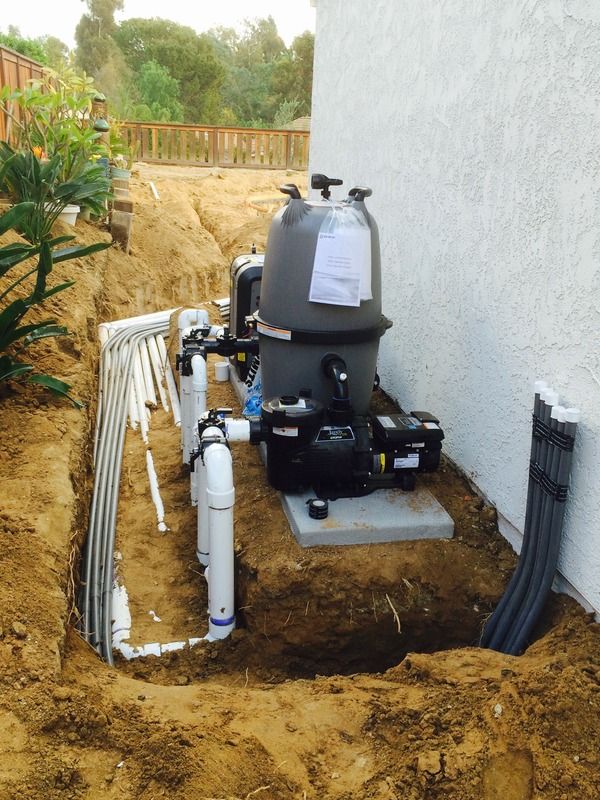

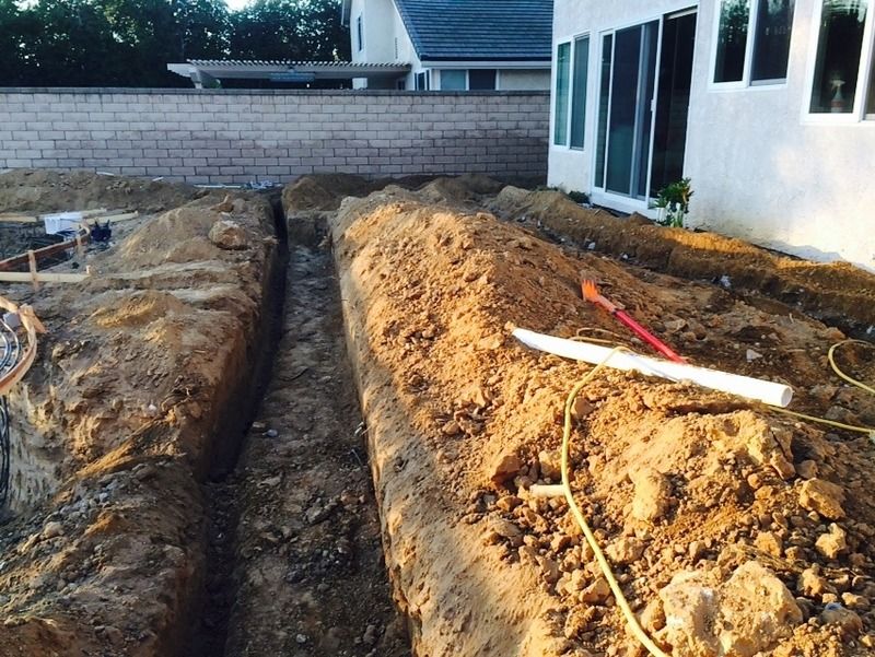

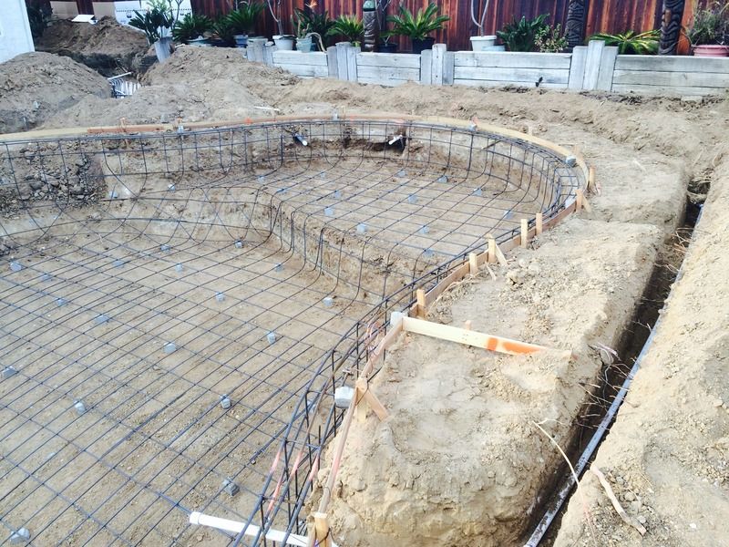

On day two of plumbing trenching etc., there is a benefit to being here as much as possible, as the PB foreman only shows up after each stage. Yesterday the equipment was delivered, I of course checked it and found the supplier delivered the wrong filter, automation control panel, SWCG, and pluming kit. Of course the subs don't know what was ordered, had I not been here the wrong equip. would have been installed. They also placed the pad in the wrong location and had the main drain PVC touching the bottom side of the rebar, they did not trench deep enough. I spoke with the PB foreman who told me that I don't need to supervise as he checks everything at the end of each phase. Okay I get that but why not be here and ensure it correct the first time??? Perhaps I am nuts, I always go with an ounce of prevention is worth a pound of cure. things are going pretty quickly but my suggestion to others is make sure you are on-site for critical items (ie. layout, placement of EQ, drains, ETC, of and the EQ pad was out of level by 1/2" in two feet, that's a lot you could see it without a level, I had them re-level the pad.
I removed my old garden wall over the weekend before the plumbing crew started. Everyone said there would be plenty of room and we could remove them later once the new walls are installed. Again, me thinking that the plumbers would not have adquate space to place the EQ, trench, and run plumbing lines I decided to remove a 26ft section of the railroad ties on the side of the house, Well, had I not removed the old railroad ties on my own the plumbers would not have been able to work. Again, problem averted but a suggestion to others, think ahead of everyone else as there are so many things going on small details get overlooked and then you can have delays and problems. In the photo with the equip. there used to be 1ft wide railroad ties stacked 18" tall, all of the dirt near the redwood fence will be removed and the new stone wall will kick in towards the fence to open up this area. See the last photo, where the ceramic FROGS are sitting, the new wall will kick back to within 12" of the redwood fence and extend all the way back to the front redwood gate, it will be 18" tall and widen that entire area up from 4FT wide to 8 1/2 ft wide.

I know it does not matter to some, but I love the way the Jandy equipment looks!
Agree, I really liked the look, also the handles on the filter, the fact it made of resin vs fiberglass, and the efficiency of the equipment. that was the tipping point, but I believe the CV series filter and versa plumb kit straight-thru design increases efficiency by quite a bit also looks really clean. They also painted all the exposed PVC Jandy grey, looks very sharp. I will post a photo of the eqipment set. Jandy, pentair, etc are all good.

It looks like they plumbed your pool cleaner line so that it could also be used for a pressure cleaner?
Thanks in advance for any other pictures of the equipment. What is the total width of both equipment pads? I'm playing with the layout for my yard right now and since you have the versa plumb kit, it would be handy to know how much real estate I need to carve out.
Given how much supervision you have to give to the whole process, I'm convinced I'm going the owner-builder route now.
The pad is 8x2 feet. Here are some photos, not sure about all the details, the actuators for the valves still need to be installed when the electrical crew gets here. They did put a back wash valve that is plumbed to the clean out. They plumbed the main drain to the skimmer, while not optimal, I have a sump pump and will use that drain when the time comes, the clean out is about 30 feet from the pool. Not sure if I can drain below the skimmer using the backwash?

Brian, what do you think? Not sure what that capped 3" pipe on the far left is??
Plumbing looks great, you should be pleased.
The cap is to access your cleanout and they created an air gap for the back wash line so that there is no chance of sewer gasses backing up into your pool system if the trap was to dry out.
Overall, a very quality job with the exception of the main drain tied to the skimmer :pth: You will not be able to use the pool pump below the skimmer mouth without some plumbing ingenuity in the skimmer or cleaner line, both of which are possible but not necessary since you have a sump pump.
Thanks, they told me I could drain using the pool pump, not sure why they did not plumb main drain separate, I will ask the PB about that, but I would rather not have them tear anything apart now. Plus I believe the sump pump is a better option for draining. i think I can still use the circulation pump to drain below the skimmer as you said. They do this great job and then try to save $30 in PVC. I believe most PB feel you will just use a sump pump.?
The rest:
Talk to them about encapsulating the autofiller into the gunite shel (similar to your skimmer and how the forms look around it). The way it is set up now could cause a crack in the plumbing if the deck moves from expansion/contraction.
