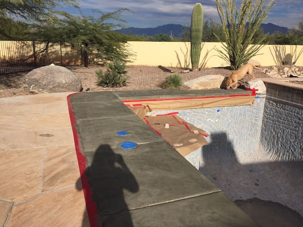

The acrylic is done. They did good job but the wife thinks we may have picked out the wrong color as it is very bright and she "needs sunglasses to look at it". I am wondering if it will tone down after it is sealed. One more question for the PB.
Here is a photo:
Just spoke with the PB. He said that the brightness of the acrylic is the second most common question he gets just behind coloration of the PebbleTec immediately after install. He said the deck will most certainly town down and that I shouldn't be alarmed. More good news is that he thinks we can get back on schedule, weather permitting:
