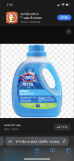

Holy Crud - not to be stupid but I don’t know how to measure that. I have liquid chlorine, baking soda and this stuff….I really appreciate your help!

Return the clarifier. Not needed.
Use the Poolmath app for how much to add. I see you are using it on another thread.

Ok. Clarifier is from last year so no biggie. I can’t get the free version of pool math to do anything! Sorry - I’m not dumb but this is challenging for my senior brain! I guess I need to get stabilizer?
