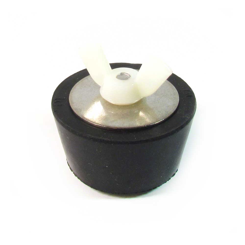

Forgive my ignorance….so the 10 or so jets I have around the pool, I should plug those up? Where would I purchase those plugs? Are the rubber or screw in?
Would need to see a picture of the return fitting. Do they unscrew? If so, the pipe is probably a 1.5" female adapter. These can be used:
If the port isn't threaded, then these:
