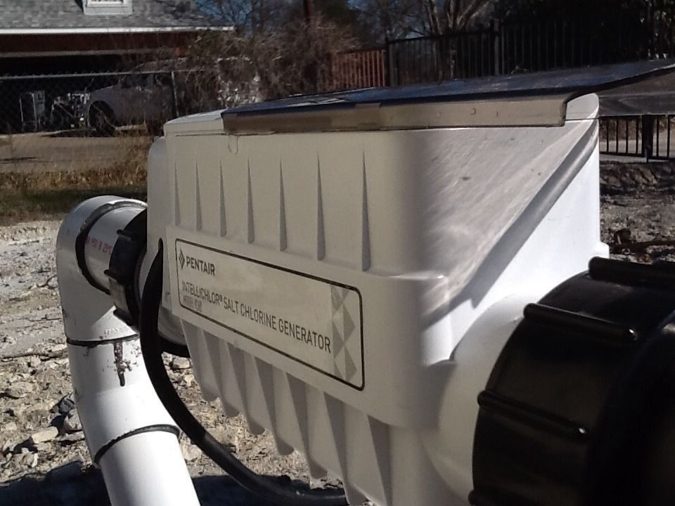

Call Pentair and send them the photo. There should be no leaks from there.
In the meantime, get one of these -
Amazon.com: Pentair 520588 Dummy Bypass Cell Replacement Pool/Spa Sanitizer and Automation Control Systems: Patio, Lawn Garden
So you can isolate your IC from the system.

Thank you, Matt. I have contacted Pentair and begun the warranty claim process. I have also ordered the part you linked to. From the looks of it, it will be good to have one of those even after this cell replacement is over.

Thanks for the added comments. I'm sure I will be fine, but for some reason I placed this order over the phone so I don't have an email record/invoice to provide for the registration process. If there had been something attached to the shipping box I don't know what I did with it, so now I have an email in to Sunplay asking them to send me a new invoice for the order. (Fortunately I did write down the order number.) I'm anxious to get the warranty stuff squared away so I can get the replacement cell ASAP, so this small snag is letting me practice some patience.
One question though... I ordered this IC60 cell with the power center included and it was bundled with my EasyTouch automation. I'm wondering if they replace the cell, will it have the power center included again, or do I somehow have to rewire the power from the old cell to the new one?
Also, when I replace the cell with the dummy pass through part, does the cell's cord get unplugged from my power center, or does that part just hang out there?
Another interesting thing that I'm finding is that the information you get from the various Pentair people you talk to is not always consistent. The first time I learned that was when someone told me I didn't have to buy everything on the same invoice to get their bundled extended warranty. The paperwork says otherwise, but I have since talked to the Pentair rep who deals with claims in my area and she said based on my account of things I would be ok, and could reference our conversation. The next thing was someone told me that the installation date is the date your pool is totally up and running. When I called Pentair and they asked for the installation date of the salt cell I had to give the actual install date, since my pool is not operational yet. I'm not sure how much that matters in the grand scheme of things, but I makes me not want to wait very long in registering everything else.
So the cord coming out of the cell is not the "built in power center" that I thought? I'll have to go look in the morning, but this cord is connected to my EasyTouch box. I guess that's just the cord for the cell then and it gets plugged in to the power center. If that's right, what is the "built in" part that was included in my package? Is that within the EasyTouch panel and otherwise would have been a separate box?
