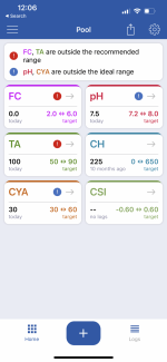

Thank you! I tested everything last night before adding anything, attaching photo of results. Used the SLAM calculator and added 1 gallon and 3 cups liquid chlorine. Pool was noticeably less green this morning, filter still running a little on the weak side after it’s been going for a bit. Tried vacuuming a little but didn’t have an extra set of hands so couldn’t vacuum to waste. Trying a skimmer sock again to see if I can get some of the smaller particles, but I guess I just need to be patient. I stopped at Leslie’s since they were the only ones open to pick up a couple of things and he said to add an algaecide because “you have live algae, but you can pour this in now and in 2 hours add liquid chlorine”. Can I add that during the day? Or do I need to wait until the sun goes down so it doesn’t burn off? Or is that more for the granular bags of shock?

DO NOT USE ALGECIDES!
Especially ones where you do not know the ingredients.
All you need for algae is the SLAM Process using liquid chlorine.
Do not get sucked into Leslies magic potions that fix all pool problems. They just lighten your wallet.
As you get near the end of the process I find that a Slime Bag helps with the final clearing.
