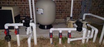

New construction. We have a separate spa that spills over into the pool. The pool and spa share a pump. There is an additional pump on the far right of the equipment pad which is a dedicated pump for a water feature.
In pool mode, the spa jet circled in red distributes water into the spa, which slowly spills over into the pool. None of the other spa jets seem to be active in pool mode.
In spa mode, the spa jet circled in blue starts to distribute water into the spa and the water level drops slightly to stop the spillover effect. Also, the spa jet circled in red switches from pushing water out to sucking water in. The water level in the spa drops slowly but it continually drops. It dropped to the level of the spa jets. I didn't let it go any further than that.
When returning to pool mode, the water level in the spa raises back to a normal level, and the spillover effect returns.
I have attached a picture of my equipment set up, and a picture of the spa jets circled in red and blue. Is it normal for one spa jet to switch between a return function and a suctioning function? Any ideas of what could be causing the water level to drop?
