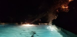

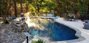

Lol. They went out of business, surprise surprise. I love my finished product although I had to do some of the things that they never came back to repair. When I saw your waterfall, I thought "that's my exact waterfall". Than the same system and being your in MD I knew it had to be Catilina. I've attached some pictures for your entertainment😂

Yep you have the same coping and stone-marked concrete. Waterfall is very similar. We found them on the back page of the newspaper ad thing with a special for 2 "free" waterfalls. We are also very happy with the product. We saw Catalina people like 1 maybe 2 times during the entire build. The day of the dig and that was pretty much it. No quality checks they just trusted their contractors to do everything correctly. Never even saw them at the end for a final walk-through. I had to sue them too because I paid $3k out of pocket to fix things to pass my final county inspection that they should have done. But they managed to evade service and eventually I just dropped the matter. Ah well life goes on.
