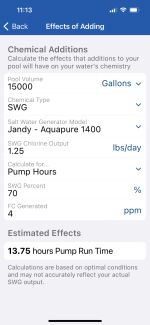

Hello all, this is our third year enjoy your saltwater pool in Texas. We follow the TFP method and use the app to balance our water. That being said during the summer it is a struggle to keep the chlorine where it needs to be. We run our salt cell and pump 12 hours a day at 70% output and keep CYA around 80 and I still struggle to keep the chlorine level above a 4 without adding liquid chlorine. Its hot in Texas and it gets direct sun. A friend of mine swears by the water choice enzymes which claim while using you can keep your chlorine as low as 1ppm. Curious if anyone has used this product with a salt pool and if so how would that effect where we keep our cya. I’m assuming if we try and keep a lower chlorine level we need to lower the cya as well. Would love feedback on the enzymes and in general how everyone keeps thier salt water pools producing enough in July and August in Texas. The rest of the year isn’t a problem.

At your current pump runtime and SWG percentage, your SWG can't keep up with chlorine demand.
Your choice to up the runtime and/or percentage or add liquid to make up the difference.
