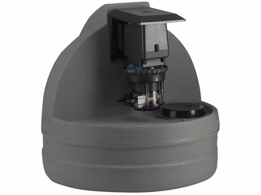

Why not just setup a Stenner tank to dose MA that you can automate through a relay in your Jandy controller. Don’t bother with pH probe feedback and all that complication. Just simply set the acid dosing pump to run for a short time once a day and then test and adjust as needed. Given how high your TA is in your fill water, you are in very little danger of crashing your pH. As long as the acid dosing pump adds a little acid each day, testing every other day or so should reduce your burden considerably. You want avoid trading one pain in the neck (testing and adding acid every day) for a different pain in the neck (fiddling with pH probes and a finicky automation process). Just get an acid dosing pump to run on a fixed schedule and it will be very easy to maintain your pool.
I second JoyfulNoise. I have a Stenner pump with an acid tank which runs for a fixed period each day. Works great, low cost and low maintenance. Once you have the system dialed in, I have found that I don't need to adjust the feedrate. Just fill the acid tank every few weeks.
@JoyfulNoise and @dschlic1 -- Can you assist in helping me figure out what I'd need to buy to make that work (relating to equipment/parts)? I guess I'm a bit confused how to even go about figuring those pieces out. Any pictures of your equipment/setup by chance? Sorry for my ignorance on the build-your-own, that's why I was looking at other options.
(I still like the Hanna BL100 a lot, but willing to consider this alternative)
Wow this is cool.. Stenner peristaltic metering pumps build an item number tool you can build you own Stenner setup with customizing the part # needed for pump type, tank size and color, voltage (110/220), etc. that you want. Thought I'd share, it's a neat link. The following choices/selections give you the part # I found up above in my prior message.
That’s exactly what you want to use. A fixed rate pump and tank. Simply run the pump using your automation system. That way you can schedule the dosing to run whenever you want.
Just make sure to use the highest quality check valves and tubing with muriatic acid. Also, buy spare tubing as it will only last a year before it needs changing.
